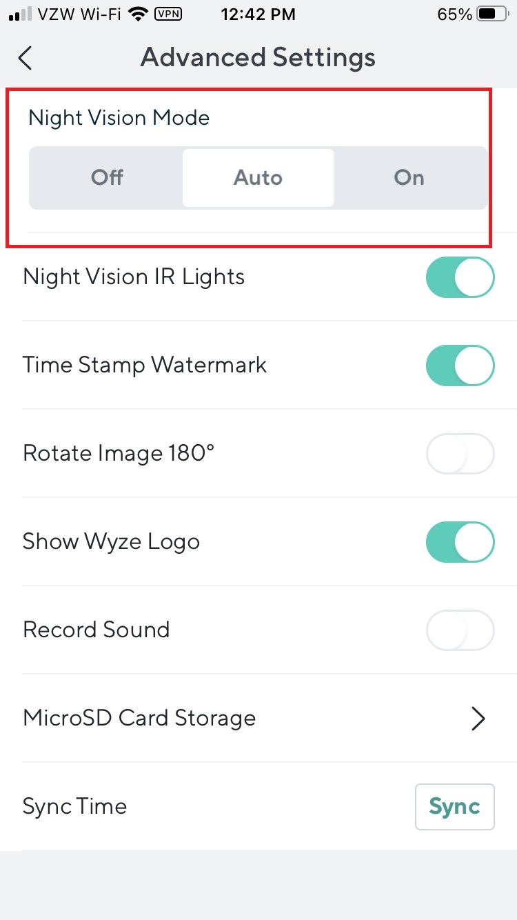

When my outdoor cam is triggered for motion it has 4 seconds of lens flair and then another seconds to clear itself up. Also when set to auto for the infrared it wont toggle from day to night on it own, its just stuck on night mode. Both the cam and the base have been updated to the latest firmware. Ive even started a support ticket with a video example but thats been 2 weeks now and ive had no reply.

Looks like it is stuck with night vision on for sure. Does it switch to color in the day time if you manually turn night vision off?

It does toggle from night to day when i manually switch it. It still flares when it is set to daytime. the flare is just a lot quicker. 1.5 sec id say.
