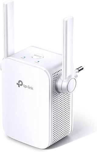

I know they make wifi extenders (is that what they’re called? Or a bridge?) that plug in to an outlet and have ethernet out ports on them.
I was hoping that something like that would work, connect the extender to the hotspot wifi and just plug the outdoor cam base station into it.

So an extender would make sense if you just needed to get WiFi out there from another place. But if you want to use a cell phone to provide the internet connection, something needs to provide a way to tether to your phone and also provide an Ethernet port.
Careful with the extender thing. Many have Ethernet ports, but only to setup the device not to provide internet threw.
After a short search I found This I have never used it before, but if you have $20 to gamble with it might be your answer
Would something like this work?
It looks like it connects to the internet via wifi and has an ethernet port to connect a wired device to that internet connection.
It does appear that this device will work. I would try it
I appreciate your help! Even if it doesn’t work with my hotspot I have a (non necessary) use for it at home, so wouldn’t waste any money.
Good luck. Let me know if you need any help setting it all up
