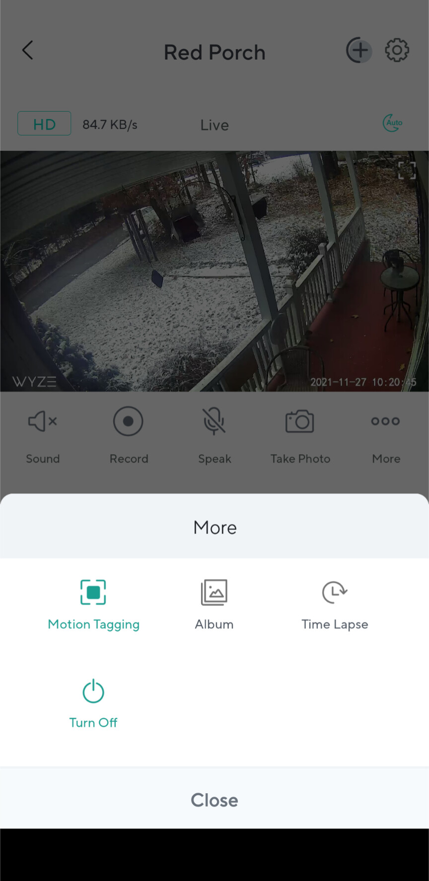

I’ve got Motion Tagging enabled, but I never see the green rectangle when walking around, and never get notifications of activity. When I looked at the Playback for the camera, it gets a little weird. I attached a screenshot. That blue highlighted area on the timeline corresponds with the time I was in front of the camera, but I can’t play that back. I can’t even place the cursor in that area. The timeline just jumps to just before or just after. And that blue playback highlight will disappear if I look at the playback later on. So it seems that the motion detection is partially working, just not following through.

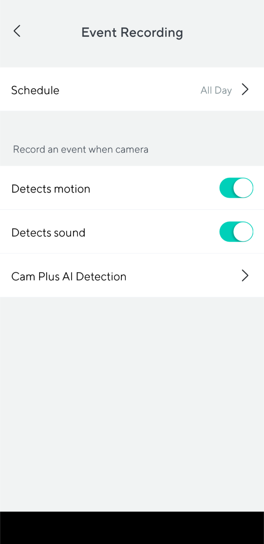

Your talking about local storage (SD card) and cloud storage (camplus, free) together. Those are each operated independantly and seperatly from eachother and each have their own set of settings. Notifications are triggered from cloud clips. You say the settings are the same, but what are your camera settings? Can you post a screen shot of the non working cameras event recording and notification settings pages? Do you get any events in the event tab from this camera? Remove all filters for troubleshooting.
Thanks, Omitsgtony. I do realize those are different functions, but I think my problem goes deeper than that. At the very basic level, I’ve got motion tagging turned on, but when I walk out there in front of the camera, I never get the green rectangle at all. So it seems that the camera isn’t detecting motion at all. And if that doesn’t happen, it will never get to trigger the SD event recording nor the cloud storage of motion. It just doesn’t get that far. The screen cap I posted only shows a weird behavior. The timeline seems to indicate there was motion, but it’s never actually stored. And that highlighted are on the timeline isn’t there if you check again.
Anyway, here are some of the camera’s settings. FWIW, the Detection Settings show I have Detection Zone ON. This was to try to exclude my street from triggering. Just to check, I turned that OFF and still no motion detection.
