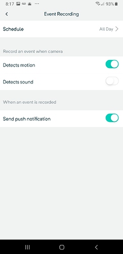

what cameras are they? pan or V2 and can you post a picture of your notifications and detection pages in the app

The pictures of the notifications will be pointless as it doesn’t show the missed motion detection. I know it missed as I drive/walk by 3 cameras to get to the back. And in some of the tests couple will detect. And one never does. Next time only one of the two which previously did it will not detect. They all worked great before the update.

I was only hoping to see your detection setting page. just out of curiosity. having this issue make sure to send a log to the developers. maybe it is something that is known, or maybe not. I wouldn’t try to downgrade if you are afraid it might brick it. if anything contact wyze directly and see about a possible replacement.

Here are screenshot of the settings.
