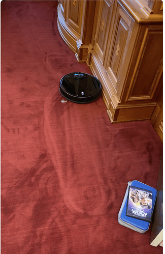

I had images prepared for each of these posts. But Wyze does not allow new users to clearly document their points with multiple photos…undoubtedly an effort at damage control; under either the guise of preventing spam (???) or COVID-19 (General Excuse #1 for everything.)
Photo showing stair Newel trap:
Photo showing a lack of status information for each robot in the app:
Photo showing where the robot endlessly looped on the small splotch of carpet:
Photo showing the frequent mal-alignmen t with the charger:
IMG_1223
Photo showing the simple thread that the vacuum cannot pick up:

You can also add this weird mapping problem to the list. At least once per week the vacuum will be moving around strangely and I’ll pull up the map to see this:
If you can’t tell, a smaller version of the larger map is sitting on top of the main map. It will clean some small area, then get stuck trying to make it’s way back to the charging station, so I have to physically pick it up and put it on the charger and have it start the cleaning over with the map up on my phone to make sure it’s not messed up this time.
