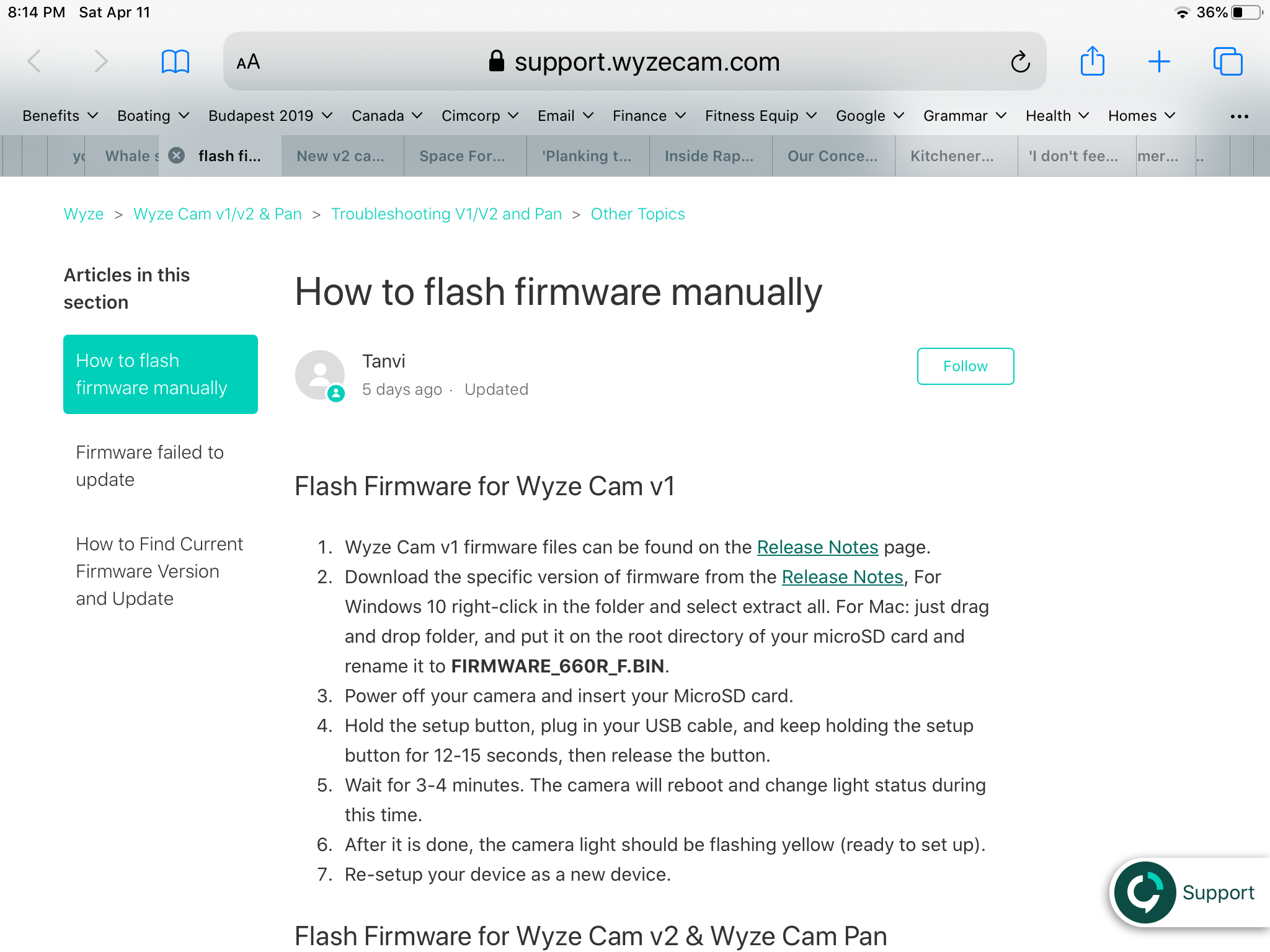

New v2 cam does not trigger on any events
You need to flash it. That is download the firmware to an so card. Follow you will find the instructions in this picture. Sorry I cannot do better.
