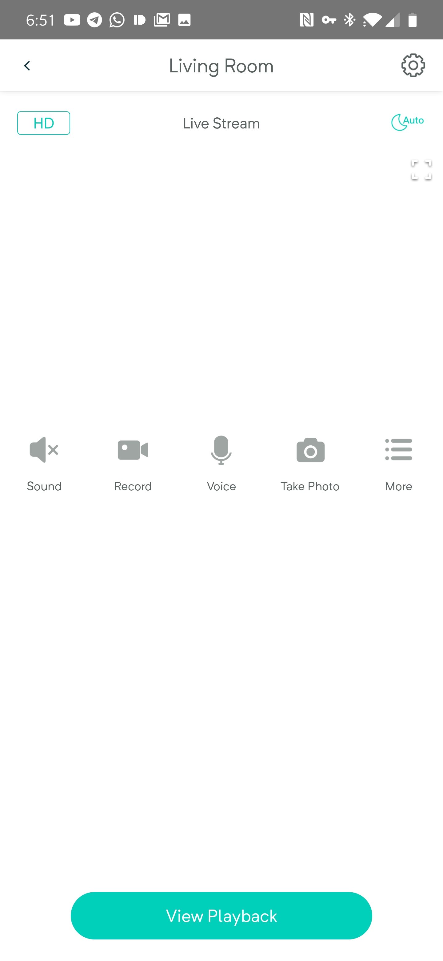

Not sure when this is started exactly but I want to say probably with the most recent update. I still get notification with actual picture but when I try to watch the live stream all I see is a white screen. (see attached screenshots)
What I’ve tried:
  • Power cycle the camera
  • Restarting the router
  • Uninstalling and reinstalling the app
  • Toggling day/night modes on/off/auto
Still seeing white.
I’m having the exact same issue on android and my OnePlus 7 Pro. I used Tinycam and can view the cameras fine. I rolled back to the latest official release (using apk mirror) and it worked fine.

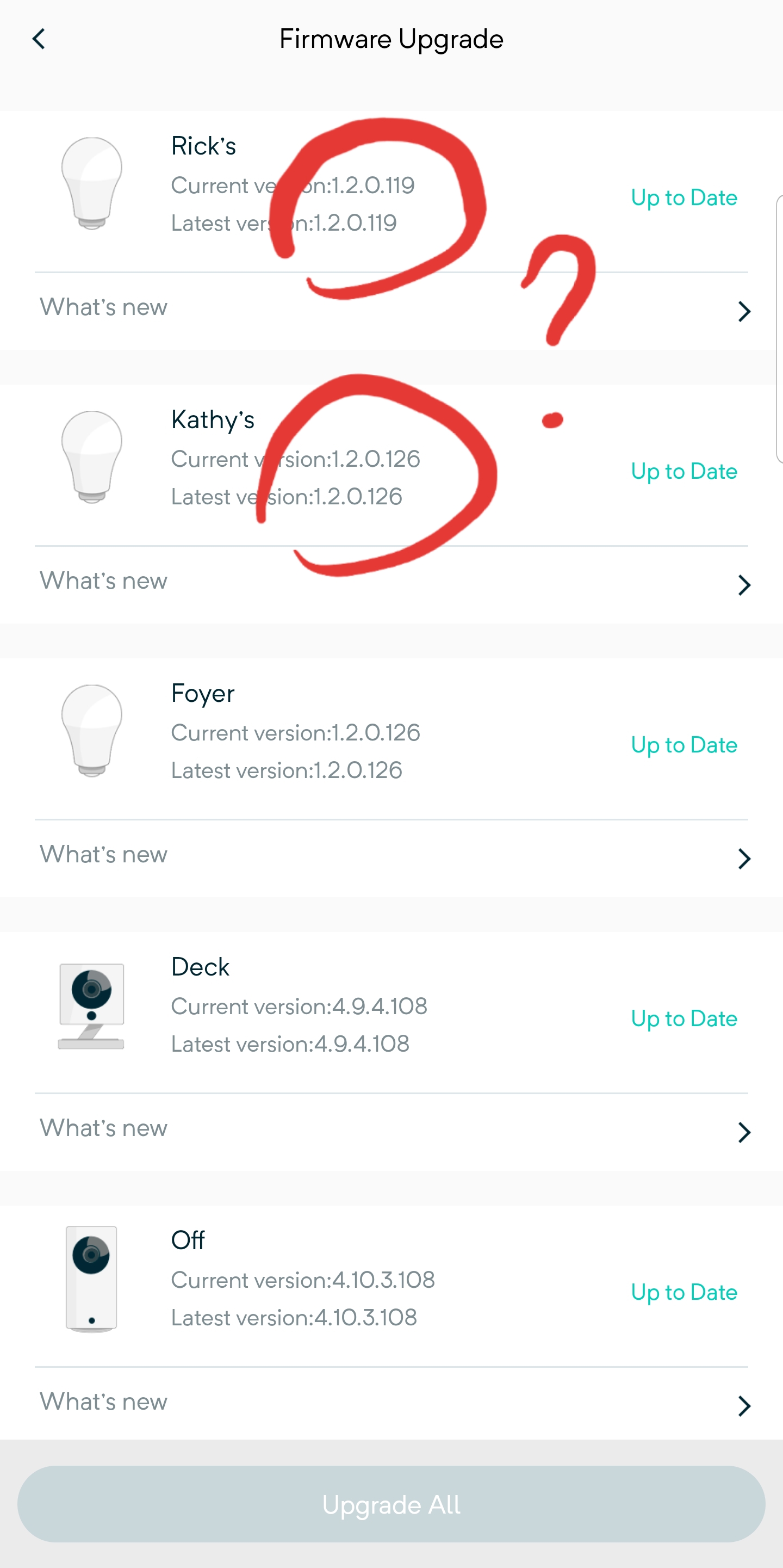

I had a bulb stop working, so I replaced it with a spare. Can anyone explain how two bulbs have 126, but the newly added one shows 119, and shows it’s up to date?
20190815_130-321
I noticed when I started setting up a new one yesterday it only updated to 119 where the ones I did a few weeks ago are at 126. I just had not had time to look into it. The only thing i can think of is maybe 126 got pulled. Maybe @UserCustomerGwen knows more or can direct the question the right way.
Mine are different v .106 :thinking:
Uh… I’ll check on this.
Mine are the same as yours , I just assumed because I am not in beta program at present time that I would not get the bulb firmware updated to 1.2.0.126
Ok, gotcha. I forgot I was in the beta thread. :rofl:
Sounds like me , when I go into the kitchen and forget what I went in there for :grin:
