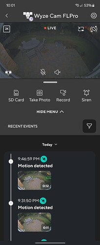

New app has done away with any sound and mic controls for floodlight pro… No speaker icon, no mic icon.

I just looked at my Floodlight Pro and the Mic and Speaker is available on mine. Tap on the Live Stream and they appeared for me.
Here is the image:

I’m on Android, speaker and mic aren’t there on live view, but seams they are on group view.
Floodlight control, resolution pic n pic also not there.
