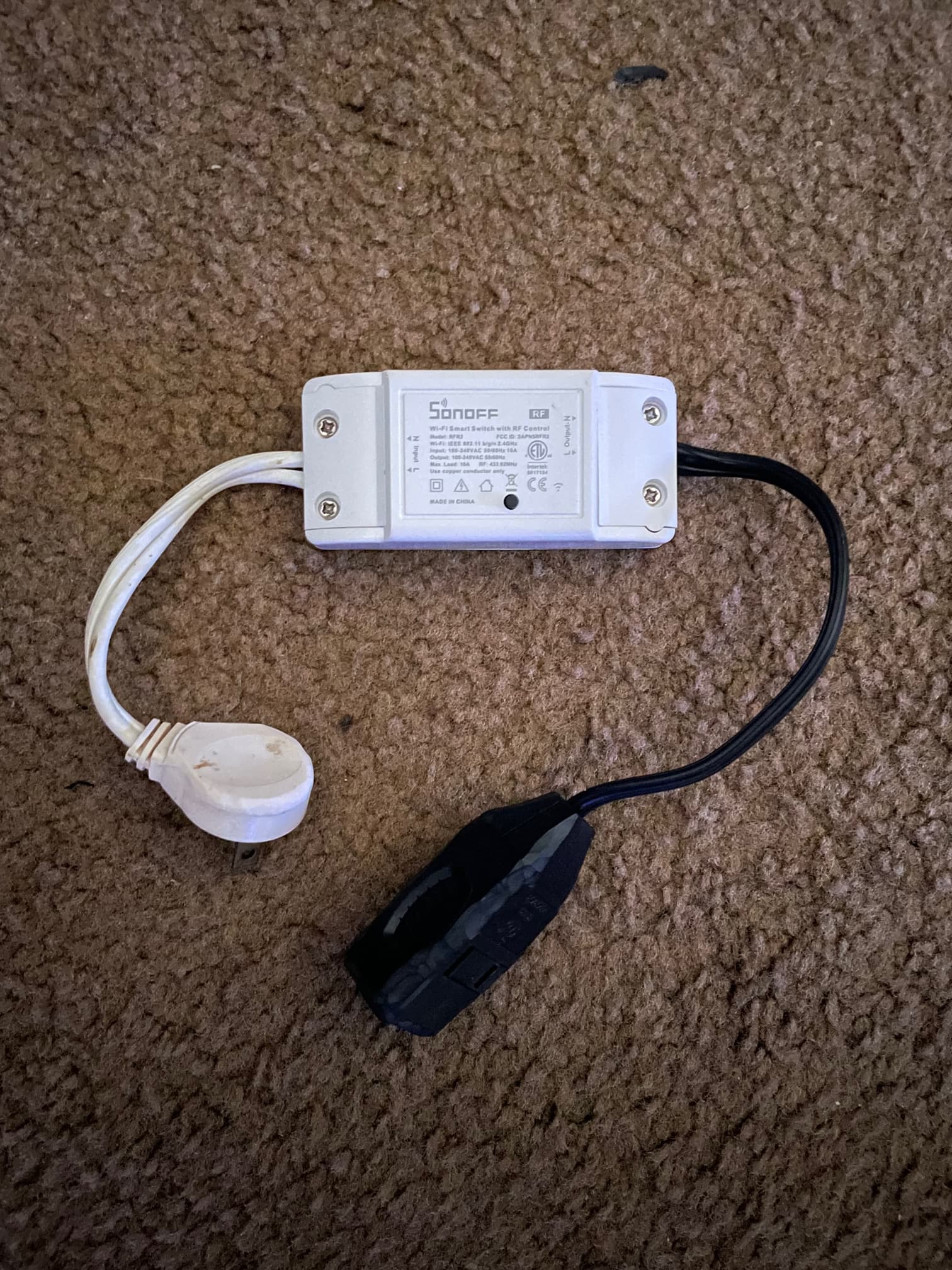

This is what I am doing now. I made this and it fits. This is a Sonoff Basic. With RF capability. I use them lots of places. Love being able to use a 8 button RF Remote to consolidate a bunch of 433 remotes together.
Note that it does not have a ground lug. I just replaced the $80 fish pond pump and don’t want to cut the third/ground lug off the plug. So, I have ordered a short extension order and will cut the female end off to use on output side. (Could/might use male end too, and run grounding wire along outside of “Basic” and separately connect the grounding of male and female to be safer. ) But maybe not, because I need that flat male end to make it all fit. fortunately, I don’t have a mission for the left over male 3-prong plug and can try it.
