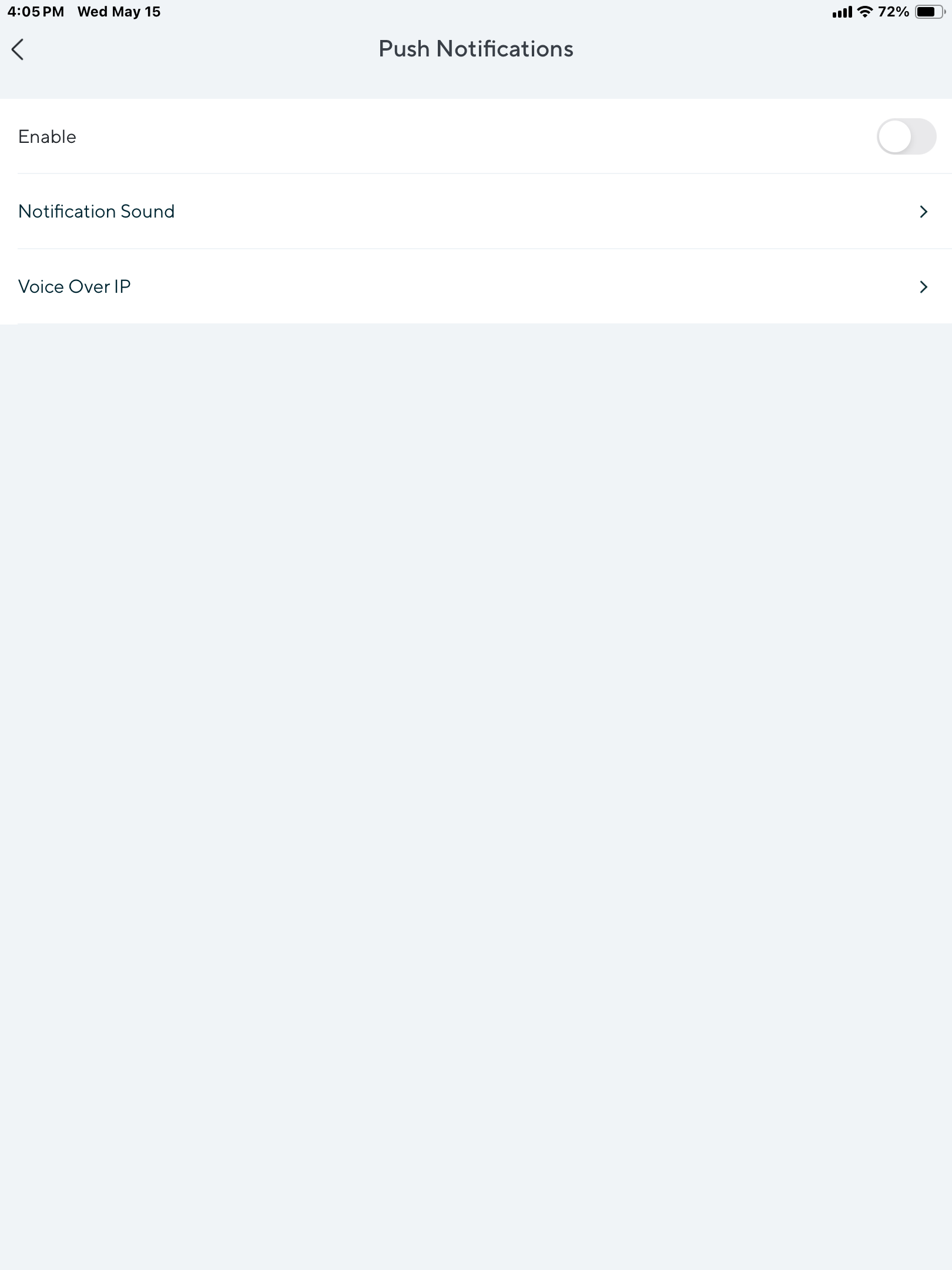

In the monitoring tab of the app, did you complete the “setup wizard”?
This lets you define the notification status for Home, Away & disarm for each camera.
If the events are triggering but you are not receiving the push notifications out sounds like you are in Home mode where by default there are no push notifications?
As an example below I had to manually setup the outdoor cameras to have push notifications when set to home.
I followed your suggestion and will see the results tomorrow…However, the 3 Cams that are critical are not supported. These 3 are my wire free Outdoor using the base station. These 3 are pointed to 3 of the outside areas where I have no AC power. They used to ping me 24/7 when a car is coming up my driveway and at porches.
The remaining 5 cams are indoors and I have a “Rule” that these do not go online until midnight and off at 7am. I have this rule to prevent hundreds of push notices as we are walking around.
To recap…the push notifications that are no longer working are the 3 Outdoor base wirefree cams. These are basically all I care about to ping me whena car is coming.
