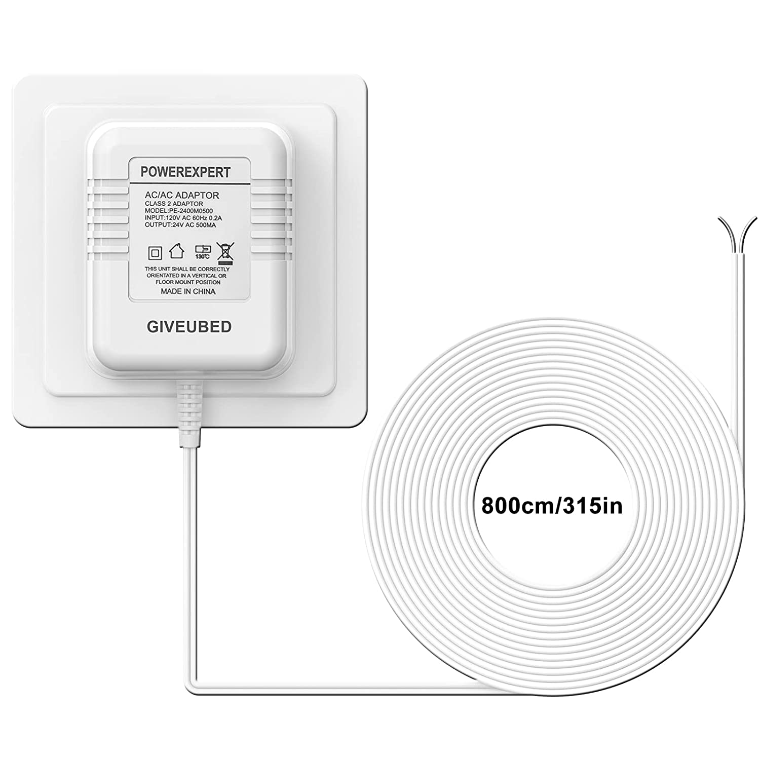

The VDBv1 (original wired only) can be wired to an appropriate power supply wall wart and plugged into a 110v outlet. It requires between 16v and 24v AC power supplying ≥10VA (have to do the calculation depending on the voltage and mA you buy)
This is the 24V x 500mA = 12VA one I purchased (with extra long wire):
Doorbell Transformer, AC 24V 500mA Power Supply
