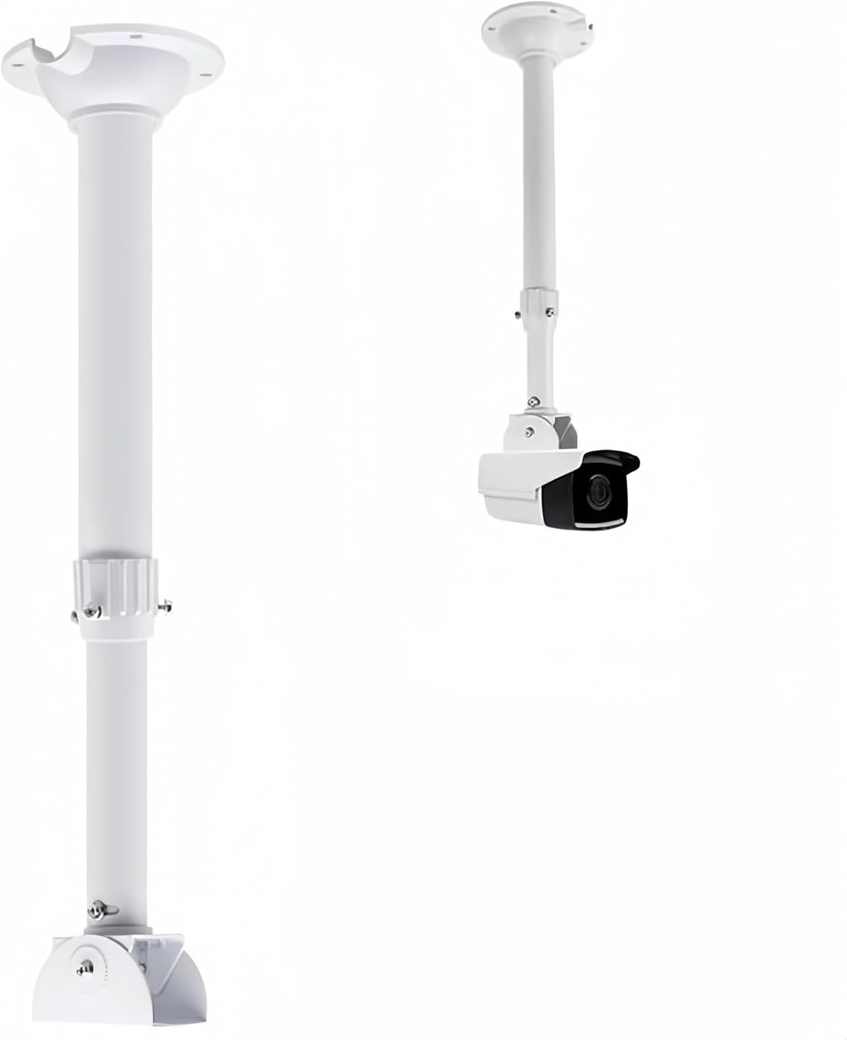

I think you pretty much have two options
Print out a bigger sticker (maybe go to staples or whatever and print it on 11x17 paper and laminate it).
Use something like this mounted to the ceiling (can probably find a much smaller one, this one looks to be for large cams)
Yep. That would work too. I ordered a bigger sticker on ebay. It’s durable vinyl and printed with metallic ink supposedly for low light. I think the best option would be for wyze to make theirs larger or at least offer a larger one. They sell a replacement sticker for 99 cents.
