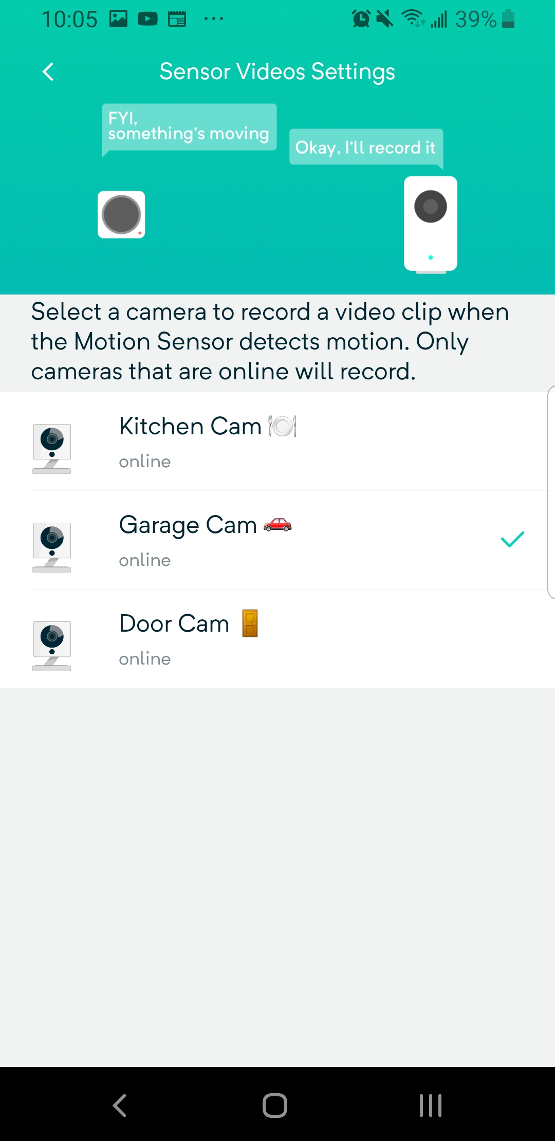

You could try keep motion detection off on camera always. Enable smart video recording from the motion sensor to garage camera. When garage door closes turn on notifications for motion sensor and keep the 45 min disable notification rule.
I pretty much get 0 alerts from my garage unless someone is actually in there using the motion sensor to trigger the camera.
Ok I’ve done what you suggested. All notifications from camera are off. Motion sensor will only send notifications when garage door sensor reads “closed”
Camera is set to no notifications but I have created a rule where IF contact sensor shows closed, TURN ON camera notification
I’m assuming with these rules all events etc will still be recorded if I want to go back and look, I just wont get told about them.
Not exactly. Turn off notifications from camera all the time (IMO opinion the motion sensor is far superior for triggering real alerts and video clips) if you are using CMC then you would want the cameras detection on since CMC doesnt work on sense generated videos atm. When contact sensor is closed turn on notifications from the Wyse sense motion sensor. I find the camera detects too many bugs so my camera detection is off. Events should still record with no notification during muted periods.
