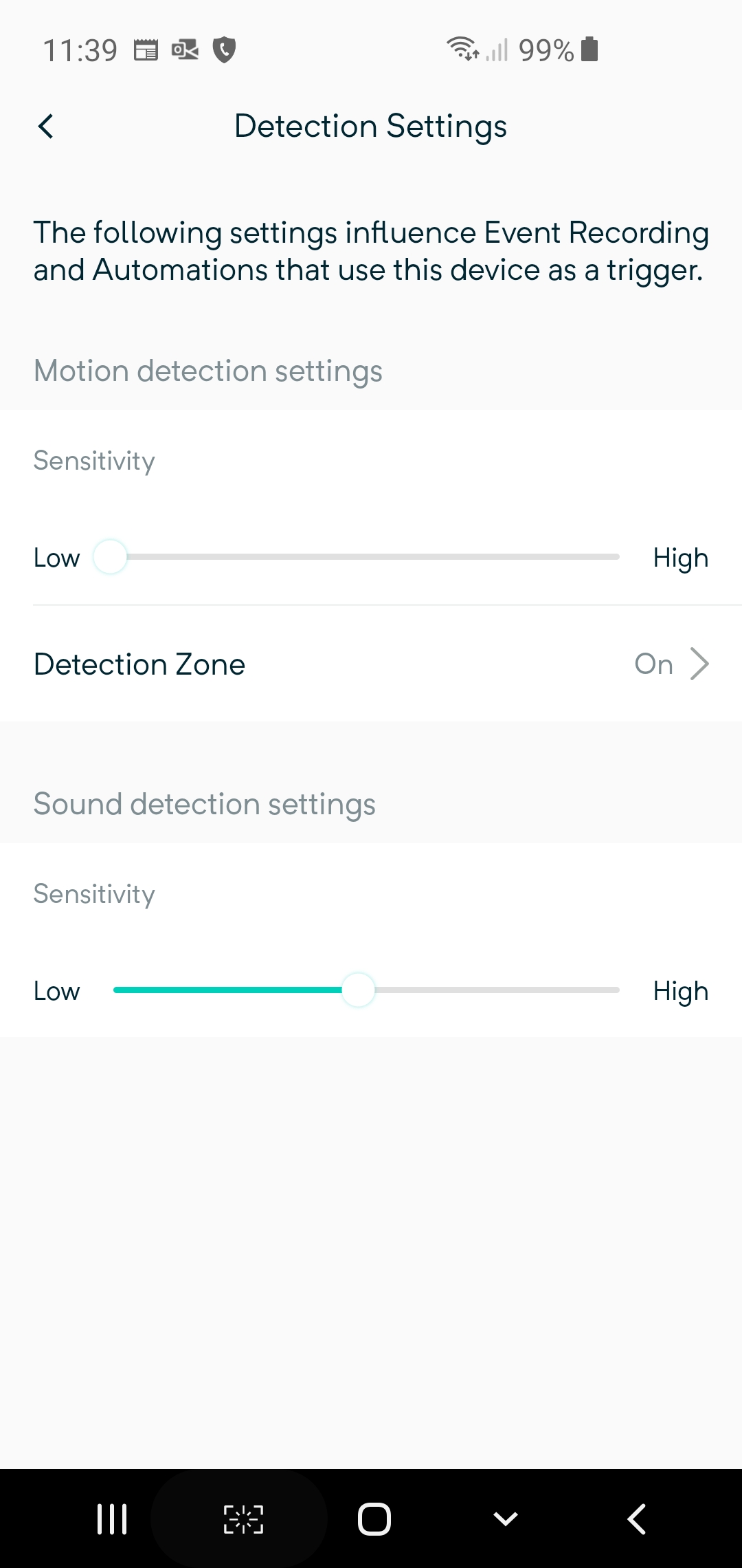

Seems I can only set it to one. Zero is unattainable, unless I switch it off. I will give that a try. Unfortunately the white dot slider disappears on the white background when set to 1.
you could also look into the Wyze sense motion sensor. using a motion sensor will also bypass the 5 minute cool down and turn it into a 1 minute clear, but the downside is that person detection does not currently work with the sensor videos.
Can you capture a screen when the slider disappears? Don’t turn it of if 1 is the minimum.
With fresh eyes and a better lit screen, I can make out the slider.
Turning it down to 1 on all of my cameras reduced my false arms from many to one. This is after 4 hours of operation.

Whatever I set sensitivity to, it makes no difference for me. Definitely should put the number indicator in a better place than under my finger.
