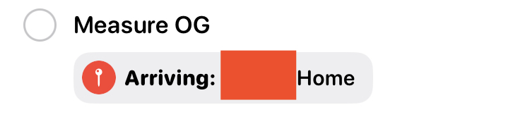

I can look tonight if no one else answers first
I appreciate that.
