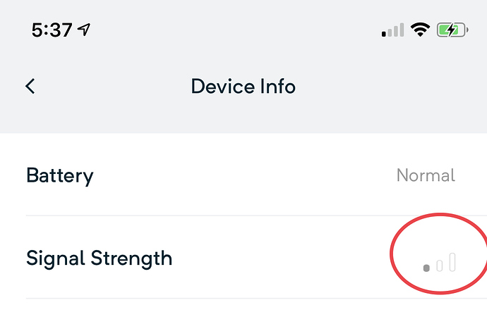

So I had to unbolt my handgun safe from my closet floor and get it to an easier place for me to work on it. I was able to finally get the sensor inside of the safe. I did have to take off the adhesive that came with the sensor and use my own thinner 3M Adhesive. Now the sensor is enclosed inside the safe so it cannot be removed unless you actually open the gun safe. image

What signal strength do you have on your sensor with the sensor inside the safe? I have a similar setup on one of mine as well!! Like you said, it’s added security that makes me feel a lot better!

It turned out that the safe was a bit of a Faraday cage. Neither the motion sensor or the contact sensor worked inside it.

It does drastically reduce the signal but mine still works fine.
