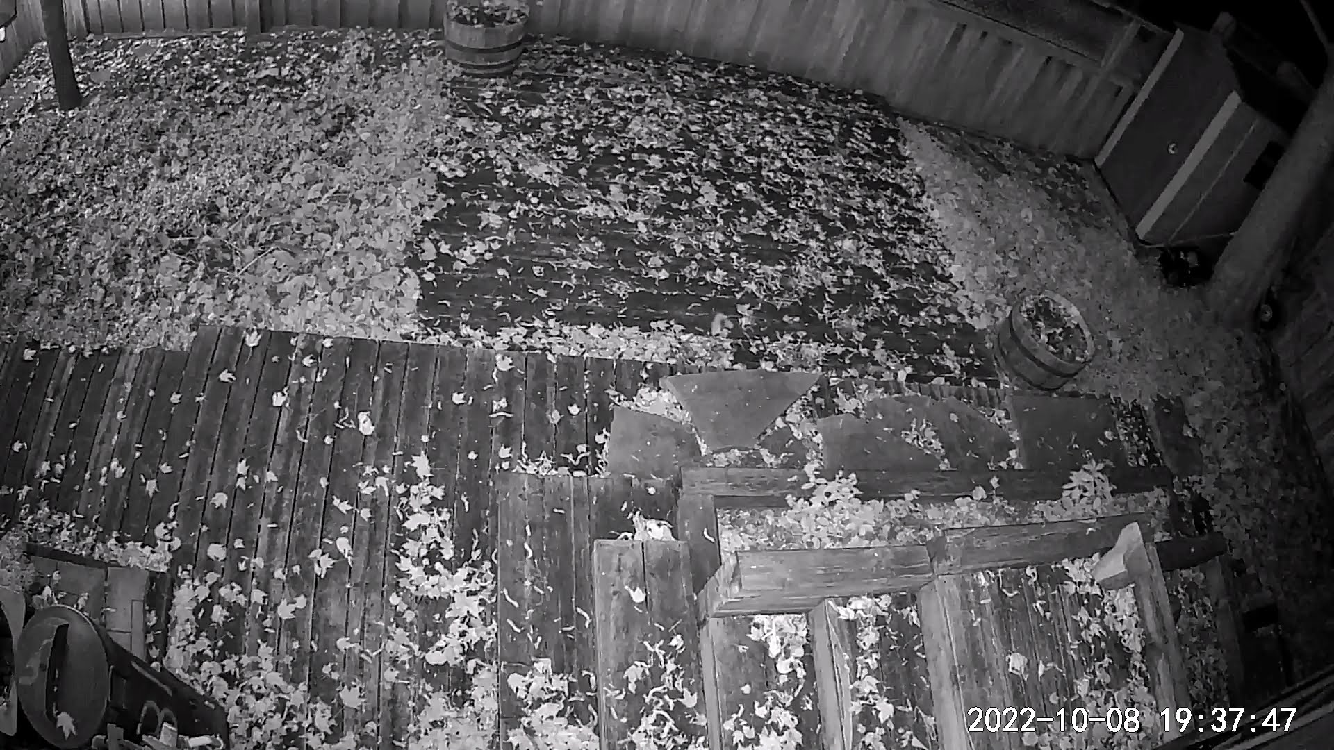

Can you send some screenshots of the bright view and the dark view (when the lights come on). Also, is it always in color, or does it ever switch to black and white

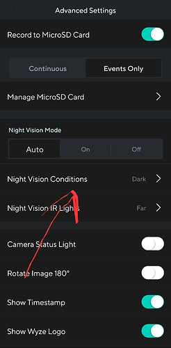

The camera on the floodlight is also a v3. A very over looked feature on the V3 is an option as to when night vision turns on,
With your cams sensing different amounts of light before switching to night vision I’m thinking this setting is different between the two cameras.
Go into one of the cams, probably the floodlight to start, and go to advanced settings.
Look for this.
When you go into that option it explains quite well the threshold for night vision to turn on.
I think this might help, but keep in mind having a cam outside on that floodlight should hypothetically expose it to more light than one inside behind glass. So play with this seeing and see if that helps at all.

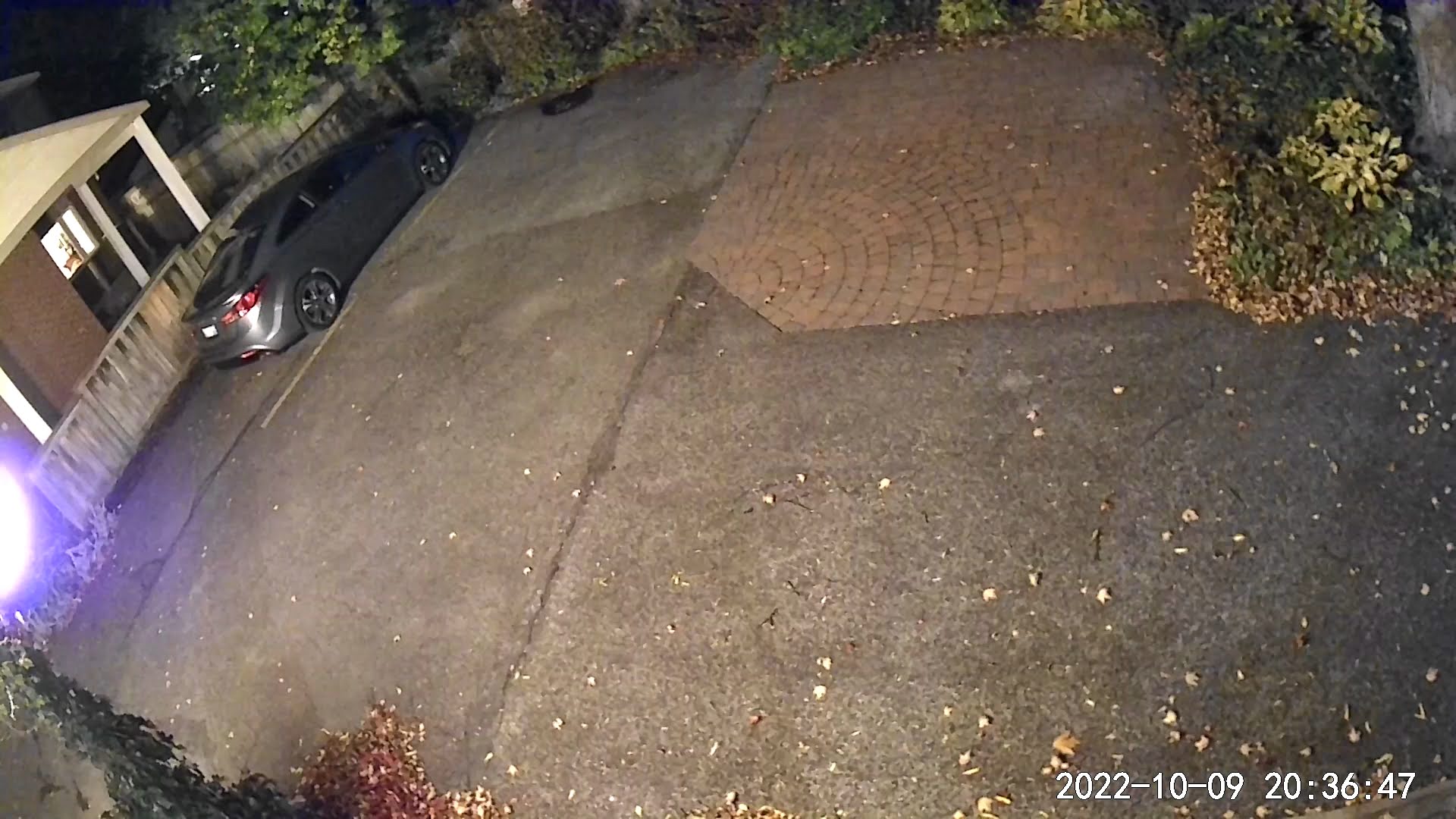

This is what I see.
In both photos, Night vision is set to auto. There is always sufficient light from the dusk-to-dawn outdoor light post (seen at the very left) such that Night vision is always off and the view is always in colour.
In the first photo, the floodlight is OFF. The entire area is very well lit. Quite impressive particularly because looking at this area through my own eyes, it is actually quite dark.
In this next photo, the floodlight has come ON. So even though there is MORE light from the floodlight, the view is significantly darker, particularly in the area approaching the car and beyond.
As I write this carefully explaining the environment, I am noticing that in this second photo, it appears that the dusk-to-dawn outdoor light post may have turned OFF (with the sensor on it getting light from the floodlight and thinking it’s daytime and turning that light off). I’m going to have to check tonight if indeed that is what is happening. If that is the case, would that explain why the v3 in the floodlight shows such a dark picture? Or even if my dusk-to-dawn light turned off, should the view that I see still be similar to the first photo?
Your photo of how much area is lit with the floodlight ON is similar to how much area I see with the floodlight on. But the fact that I see so much more and brighter with the floodlight off is my concern. (Even if my dusk-to-dawn got turned off by the floodlight turning on I would have thought there would be enough light to provide a similar bright view of the entire area like I see when the floodlight is off. My dusk-to-dawn is not very bright…certainly considerably less bright than the light provided by the floodlight).
My floodlight is also set to 100% brightness.
Yea it’s probably that light off to the left that’s illuminating the rest of the image. Try pointing one of the floodlights lamps away from it to see if it will stay on with the floodlight.

Thanks. I have noticed those settings. As mentioned, of course the indoor cam against the window has Night vision set to always off. There is a light source to the left (a rope light in a tree). It isn’t super bright, but provides enough light so I always get colour night vision and it gives a pretty good picture, as shown below.
On the floodlight, if set to Auto, Night vision conditions are set to Dark and IR Lights to Far. And when set to Auto, the view is always black and white. Despite there being enough light to give me colour from the indoor cam, there doesn’t seem to be enough light for the outdoor cam.

So this is merely guessing, but it looks like your camera that points out the window has the rope lights visible to it (in frame) and thus more light is entering the sensor. With the flood light cam seemingly pointed downward it doesn’t seem to pick up as much light. I think that’s what’s causing it not to be as sensitive to the changes. Do you by chance have a second camera plugged into your flood light? On the attached flood light camera that controls the flood light if that’s the absolute view you have to have I think other than putting in a little bit brighter light you may be out of luck. But if you have the option for another camera to run off the flood light being as there is a USB plug-in to run a second camera off of the flood light you could always do another camera from that far side, the right side of the frame for the picture taken from the flood light and that would overlook your flood light fairly closely, I think you’d be able to capture the rope light and the emitted light there so that the automatic night vision would work better, and you wouldn’t have any blind spots in that area at all either :slight_smile:
I know that’s not the answer you’re looking for but other than putting out brighter light out there I think that might possibly be the next best thing

I retested that this evening and see that when the floodlight comes on, the exterior Street light remains on. So that doesn’t explain the overall lack of brightness when the floodlights are on.
I’ve got even more light with the floodlights on, yet the image is considerably darker. Something doesn’t seem right.
Do you (or does anyone) have colour night vision from their floodlight cam and then when the floodlights come on, is the view just as bright and detailed, or does everyone have the same problem that I have?
