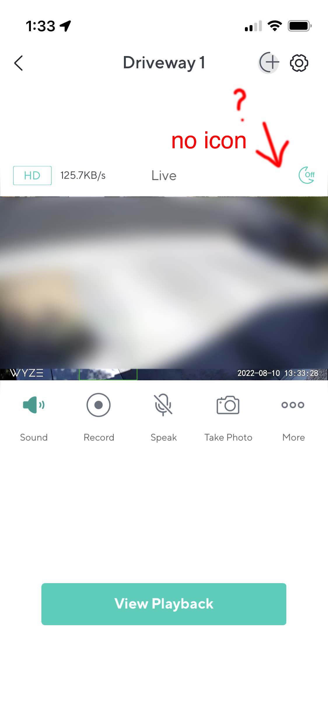

No icon floodlight with cam v3. no floodlight settings. Cam V3 is working
Please help!!! I dont see the floodlight icon ,and i went to setting in accessories > Floodlight > I have one installed. then it says this

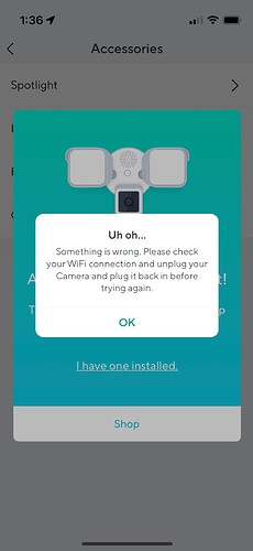

“Uh oh…
Something is wrong. Please check
vour WiFi connection and unplug your
Camera and plug it back in before
trying again.”
here is the screenshot of “Uh oh…
trying again.”

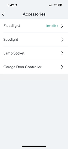

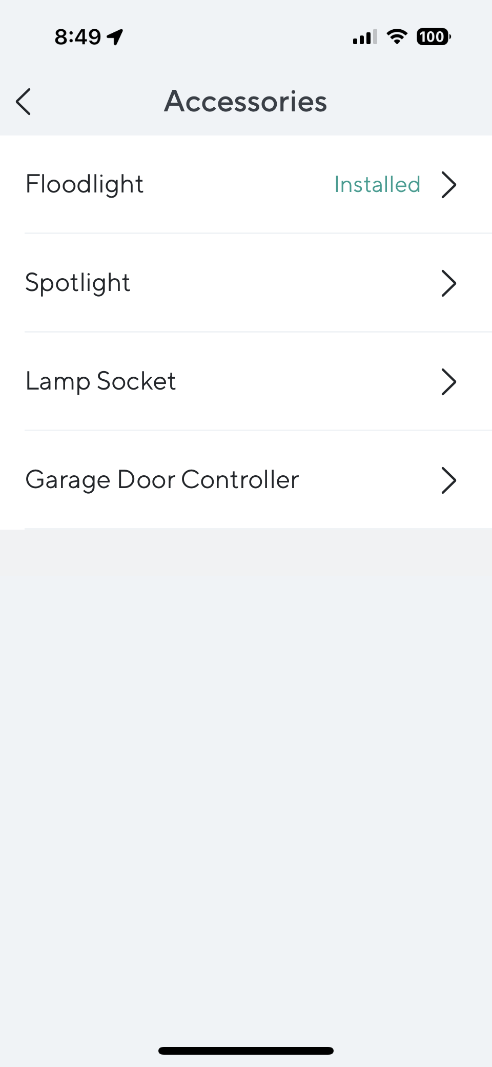

Here are the screenshots of what I get.
First I go to accessories and it does say floodlight installed, but no icon on camera shot.
After that it says I need to install a floodlight
