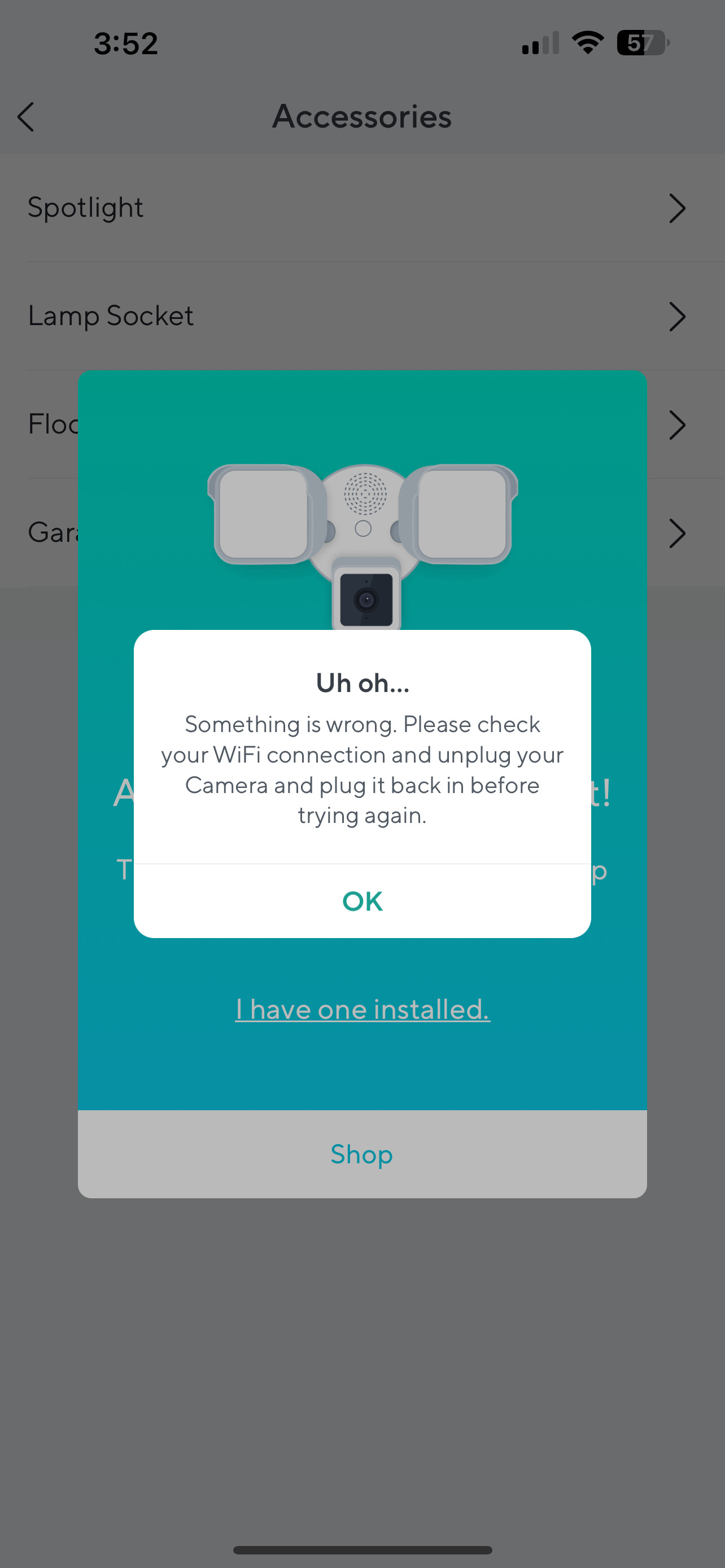

No icon floodlight with cam v3. no floodlight settings. Cam V3 is working

I just tried unplugging the cable and reinstalling still not working I restarted the camera shows it’s connected. If I click on it does nothing this has to be a software problem my light worked perfectly for a year and half.
You can’t go into that installed option right? I try to go into mine and it acts as though it’s not installed
