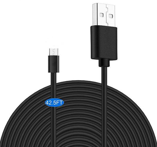

Several of my outdoor v3 cameras have been connected with 42 foot Moyeel microUSB cables for over 3 years. The key is determining the wire gauge. The higher the gauge number, the thinner the wire and that equates to voltage drop. By the time the power gets to the camera, the volts and amps just can’t power the camera.
