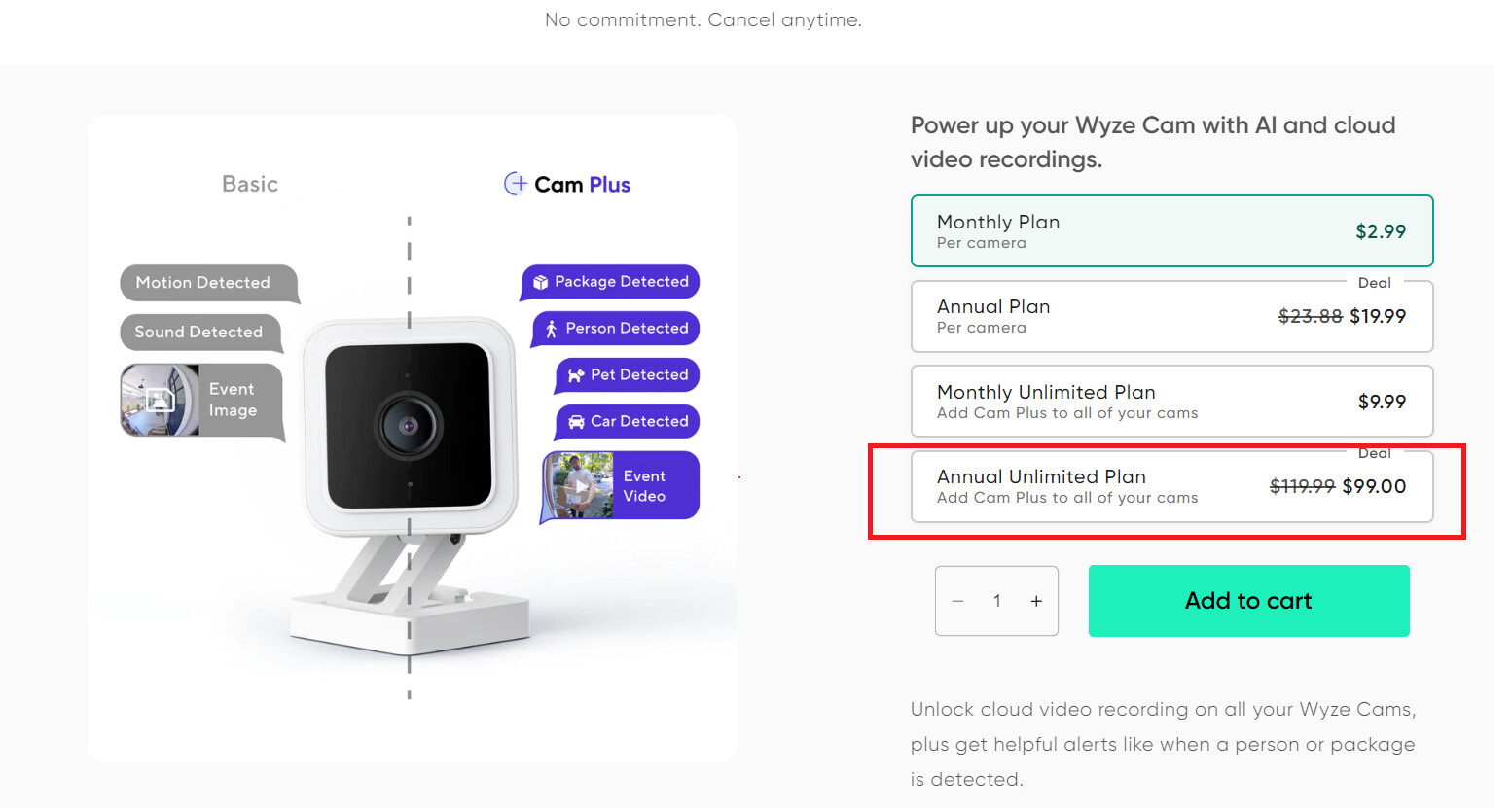

But from your answer I infer that with the free subscription the only smart notification will be for persons, is that correct? This changes my calculus, because in that case indeed I would need to purchase the paid subscription (to benefit from the pet detection aka sheep), which will total to 100$ a month for 10 cameras, it’s too much…
Don’t mean to overstep my boundaries in replying back to you instead of IEatBeans. The price is $9.99 a month for unlimited number of cameras, not $100 a month for 10 cameras.
I purchased the Cam Plus annual unlimited plan last year. It is $99.00 for up to 99 cameras. It cost about 28 U.S. cents a day. One issue with Cam Plus is it auto renews and if you cancel it prior to the expiration date there is no refund for unused portion.

As others have said, the most you will need to pay is $9.99 a month or $99 a year for unlimited cameras. Will that work for you?

Another point concerning the cost, I bought the cam plus unlimited as I have 20 cameras.
I use Edge and there is a coupon function which alerts you to discount vouchers available for the can plus subscription.
I saved 20% on the annual price using this…
For me 99$ is a great price for up to 100 cameras.
Gabbo
Yes, that’s really solves everything.
100$ a year isn’t too much for 99 cameras.
