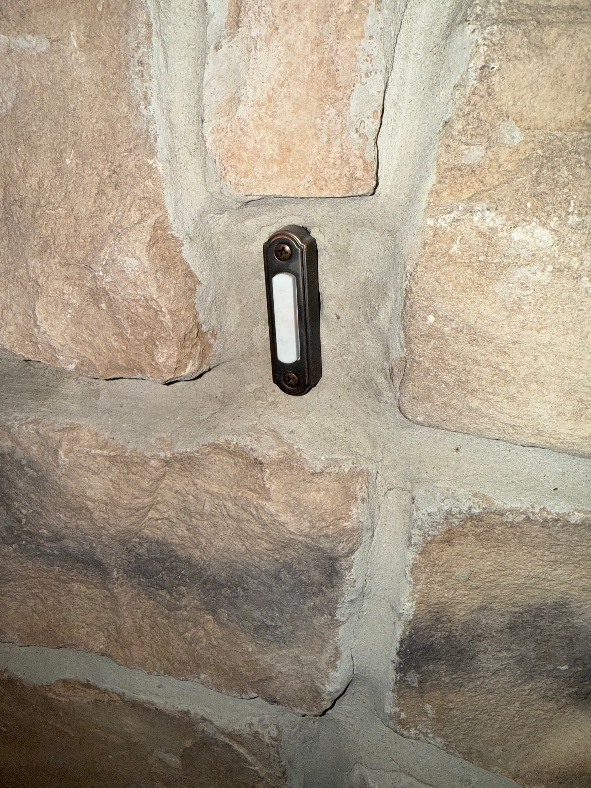

Is there a mount for a recessed doorbell and or stone?
Doorbell is recessed and there’s stone. I am renting so I’m looking to do minimal damage and be able to put it back without having to charge it.
Thanks guys!
Option: Use a block of wood or composite material: Find a small block of wood or a plastic composite material that is slightly larger than the Wyze doorbell’s footprint. Carve or shape the back of the block to match the contours of the stone. Still a hole in the center for the wiring. Then, mount the block to the stone using a strong, outdoor-rated construction adhesive or putty (or match up screws to the existing screw location). Once the adhesive is cured, you can screw the Wyze doorbell’s mount directly into the block.
