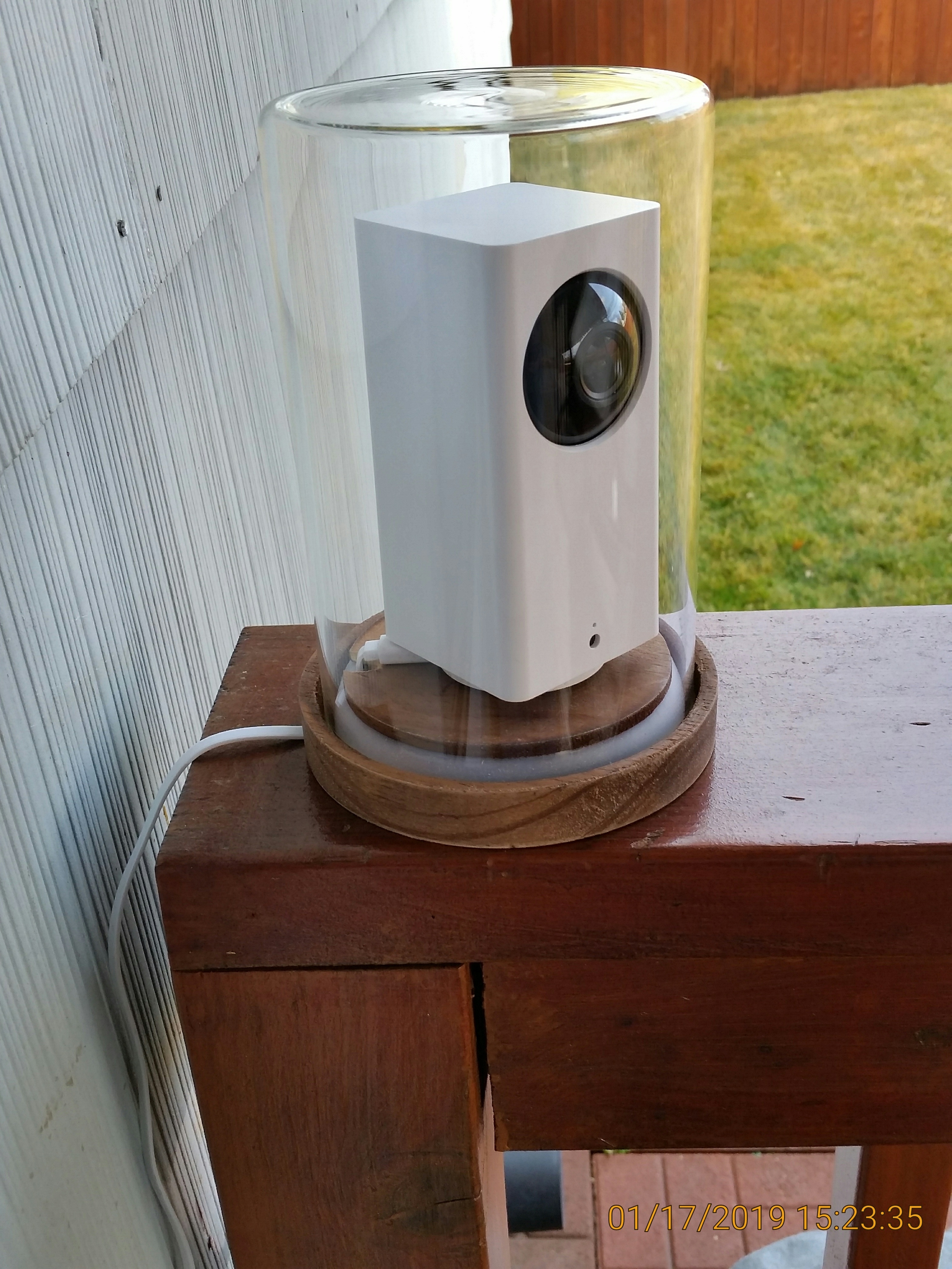

On the WYZE Cam Pan can be protected with a Glass enclosure. I used a Display Dome which is heavy glass and runs $ 24-45, but just went to Target and in aisle B36 they sell a Glass Canister with Wood Lid. It sells under the name Threshold. Drilled a hole in the base to exit the USB and the lid holds on with a rubber gasket.
Survived 2 months in AZ above 100 all the time. Top temp was 115…
