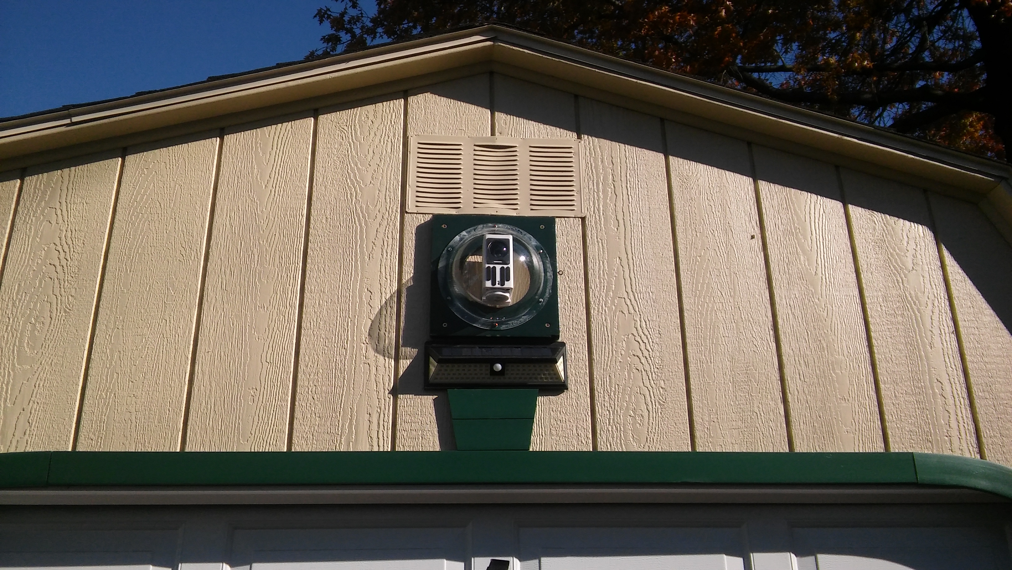

Installing WYZE Cam outside - one approach
Another idea for outdoor installation.
That looks pretty ideal for the application. Where did you find the enclosure? Thanks.
I purchased the silicone sleeve mount sold on Amazon but after receiving and looking at the unit it did not seem like it would protect the camera lens enough for the outside location and looked easy enough to pull off the wall. However it turned out to be the ideal solution for an indoor installation. I mounted it in my daughter’s living room in a location where she felt it gave the best coverage. It gives her full rotation ability and it can be tilted down to give more floor coverage. She has cats.
IMG_20181118_134957
I installed mine under the front porch awning last night with the silicone sleeve for a normal Cam, and I have to say the silicone sleeves are not very satisfactory. While it did the job it took longer then it should due to how generic the and “Floppy” the design is, it does not feel very secure.
I currently have it inverted to see if it would pick up the overhead light and kick it out of night mode, but as you can see it did not.
https://www.amazon.com/dp/B07CSJ3YTD/?coliid=I2W6W721YJJOB9&colid=BF5YKY8OHPLV&ref_=lv_ov_lig_dp_it&th=1&pldnSite=1 is set I ordered.
Easy to build.
-12”x12”x3/4” piece of plywood
-Clear Silicone Caulk
-8” Supreme Tech Clear Acrylic Dome/Plastic Hemisphere (purchased on Amazon)
-Brass Screws
Cut a 7” hole in the 12”x12”x3/4” piece of wood
Cover the wood with outdoor paint or Clear Coat wood protector.
Line the flange rim of the acrylic dome cover with a bead of clear silicone caulk.
Center and place clear dome over the hole, then screw it down on the wood & let the caulk dry.
Mount camera in desired location & then cover it with the dome, screwing the wood base to whatever surface the camera is mounted on
(Remember to drill a hole for the power cord!!)
Apply caulking around the back edge of the wooden mount & the wall to prevent any moisture from seeping in from behind.
That’s it!
