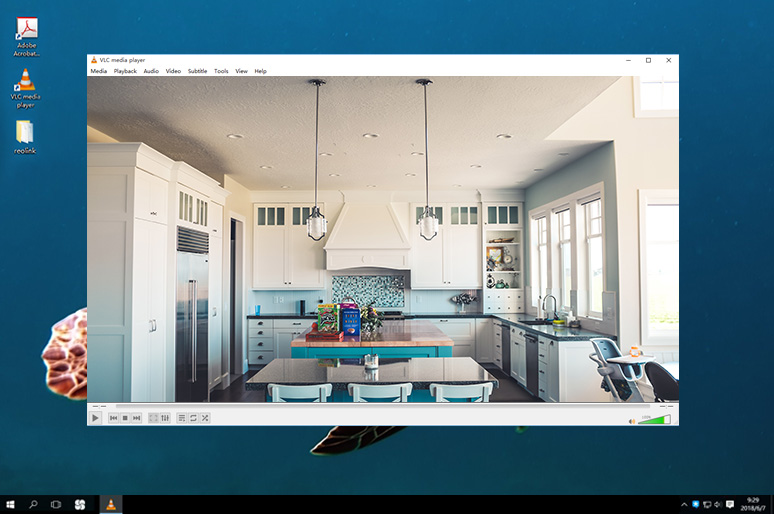

If you put the card directly in a computer, then you will find a time_lapse folder on the card. Inside that folder will be a folder for your time lapse. Inside that folder will be a “record.h264” file. That is the raw time-lapse file. You should be able to use VLC to play that.
The VLC player is not playing them. I’m really clueless on this.
On my Mac, you just double-click on the file. I did a quick search for how to do it on a Windows 10 box, and apparently you have to jump thru a couple hoops first:
