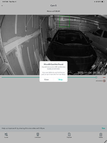

I have an SD card installed and I formatted it and it keeps saying “Micro SD card is not available”
ok, i’m fairly new to this Cam system, but I only get still shots, i have an SD card installed and I formatted it and it keeps saying “Micro SD card is not available”. I have 2 Cams now on this system (one V3 and one Pan Cam) but i want to add 2 more Window Cams that just came out for the backyard. I need help.

From the Live View screen are you able to click View Playback and view your SD card?
I get this error on one v3 when clicking the Playback button in the Cloud Events screen.

no, it’s saying the SD card isn’t available. but there IS one installed, not compatible? does it matter what SD card I use?

What size is your SD card?
Also, have you tried doing a Full Format (FAT32) of the SD card in a computer and then put it back in the camera?

it’s a 32GB, but no i did not try that…only formatted it from the app inside the cam…
Worth a shot to try. Make sure to do a Full format and not a quick.

YES!…ONE CAM v3 and CAM PAN v3, but I Have 2 more Cam Pan v3’s to add if needed. What Part of that Don’t you understand!? No, I’m not using a subscription for ANY of my cams, I USED to be able to see Video CLIPS….NOW ALL I Get is “Event STILL Shots”. and I get ERROR Message on SD Card, after repeated Formats. Can’t I just use the SD card for video clips and avoid paying subscriptions?
I’ve just done that with the 2nd Micro SD card and I Still get the error message saying SD card isn’t available. I’m so confused

yea, just did that now and still getting the same error msg….tried 2 different SD cards…same thing
Pan Cam V3’s have known issues with SD cards for some time.
I gave up on a pan cam v3 and gave it away, while another has worked as it should. There are issues from different batches it seems.

When you don’t have a subscription and try to view events in that section of the app, the app will show you only a snapshot (if you look at the plans page I referenced, it calls this “Thumbnails only”) and prompt you to subscribe. Instead of hitting the regular (play) button there, you can tap the  SD Card icon (you might have to tap a blank area of the screen first to make this visible) to navigate to your microSD card recording timeline and view video event playback there…but that’s only if your recording to microSD card is working properly, so we also need to get into that issue.
That’s really frustrating, and unfortunately some Cam Pan v3s have been having issues with microSD recording for months. You can search the Forum to read more about those discussions, or you can let me know if you have difficulty with that and I can share some links later. The short version—at least as I understand it—is that some Cam Pan v3s don’t seem to recognize microSD cards when they’re inserted, or they’ll recognize the cards for a while and then stop acknowledging that and start to throw errors. It’s a vexing problem, and I don’t know what the answer is. Several of us have tried bugging Wyze again recently to get some more attention on this problem, and we’re still waiting for a response. :face_exhaling:
Having said that, it’d be good to know if both of your microSD cards are in good working order. Have you tried both of them in your regular Cam v3 to make sure they do what you expect? That might give us some indication of whether you’re dealing with a card problem or a Cam problem, and my experience with Cam Pan v3 has me leaning toward the latter, but it’s good to rule out the former.
Something else you could do if you think a particular card is part of the problem is use the SD Memory Card Formatter to format the card in a PC and do an “Overwrite” format to see if that “refreshes” the card. Some people might call this a “full” format, and it can take a while, so you can start it and let it run while you do other things on your PC. That may or may not resolve the issue.
