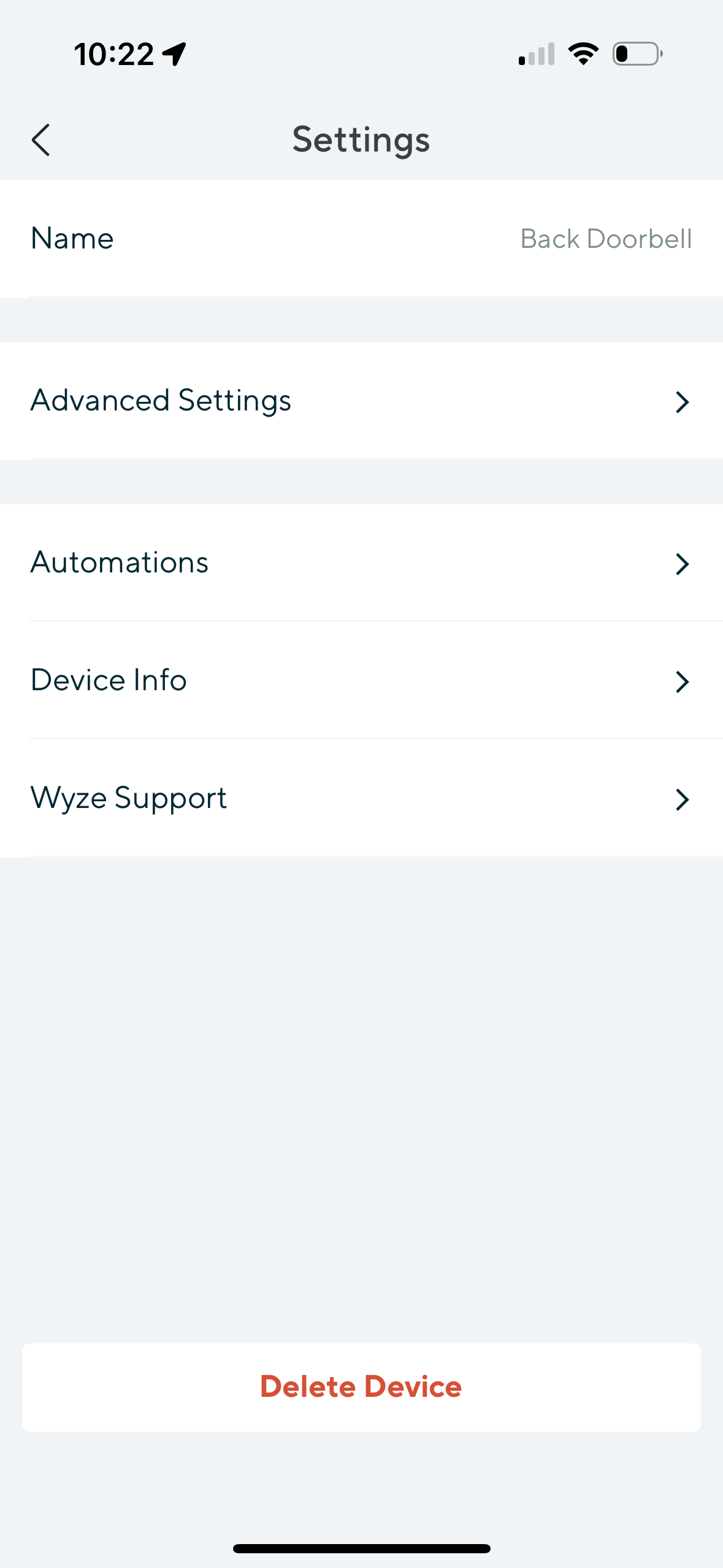

So I followed the steps in support to add my chime to the doorbell, but when I go to settings once opening the gear tab, the accessories tab I’m supposed to click on is not there at all… anyone else have this problem? And hopefully a fix? Thanks!

My settings do not look like the picture above. No accessory option. See below. I’m unable to add accessory to the doorbell. My husband can but I can’t. Any ideas as to why? My app is up to date. He’s the admin but has given me access to both devices. Any help would be appreciated.
