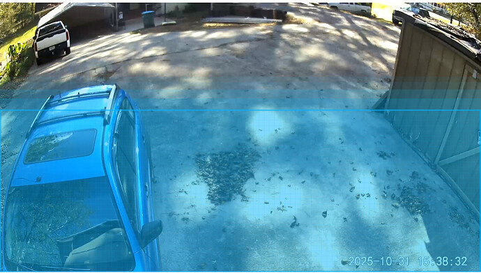

Since it is a Cam Outdoor post a screen capture of the PIR ZONE.
Everything below the red line I drew is the PIR.

@Antonius Attached is screen shot of PIR zone
Wrong camera for what you want but it can work if set correctly. These camera are horrible with movement straight at or away from the cam, like all PIR cams they work best when motion is side to side across the field of view. Your PIR zone ends at the red line. I suggest you turn the camera a few degrees to the left as shown by the yellow line. The field of view is quite wide, do a few degrees at a time to the left until objects crossing the yellow line get recorded. Either that or move the camera further to the right and aim it more left.
