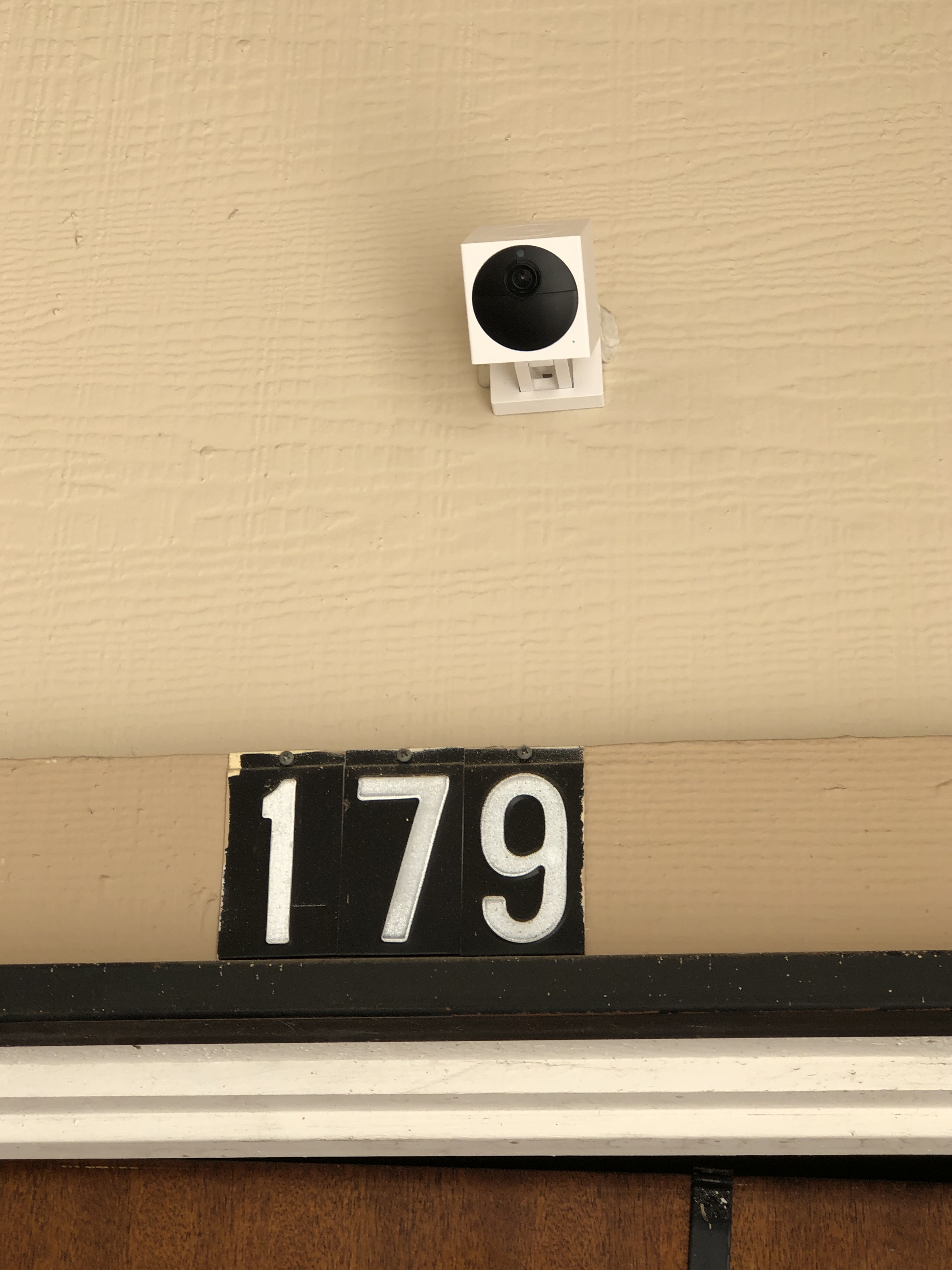

It is the Wyze Cam Outdoor. It sits above my front door. I have a long walkway but it only sees motion right by my door. I HOPE it is user error on my part but I can’t figure out how to get it to see motion as people are walking up.

I want to see the person as they are walking down my walkway. not when they get to the door.
it only catches someone at the door and it doesn’t always catch someone. I want to see them walking up the walkway
Is your camera mounted upside up ? or upside down ?
This looks to be a quick tough angle for the camera. Is it possible for you to mount the camera a bit lower, so that it sees more of the hallway ?
If you tell me it is upside down, i’ll be so happy knowing it is user error
This is upside up. I would suggest maybe try to lower the mounting position it a bit. The current angel would be someone walking straight to the camera ( straight up is harder to detect than across in general for PIR ). May be mount it so that it sit right on top of the door frame ? This will let the camera see farther into the hallway vs down to the hallway.
BTW, looks like the lens film is not removed.
it probably isn’t removed… Ok I will move it down. Thank you so much !
