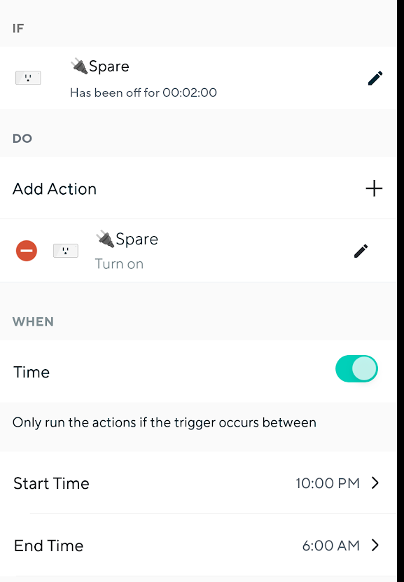

@williasp - Here’s how you do it. Go to Automations → Create Device & Service Trigger → IF “Plug” has been off for 2 min —> THEN → Turn on Plug → Schedule = 10 pm to 6 am. Like this:
Small Edit w/soapbox: The Automation that Wyze offers is the #1 reason I argue their value is higher than other companies. I truly have a smart home. And I don’t even go to the next level of automation with private automation. Their stock Automation is pretty good. Especially when using all the devices like motion or door sensors, you can usually cover a lot of bases in terms of how you want things to be in terms of on or off. It’s usually one or the other.
