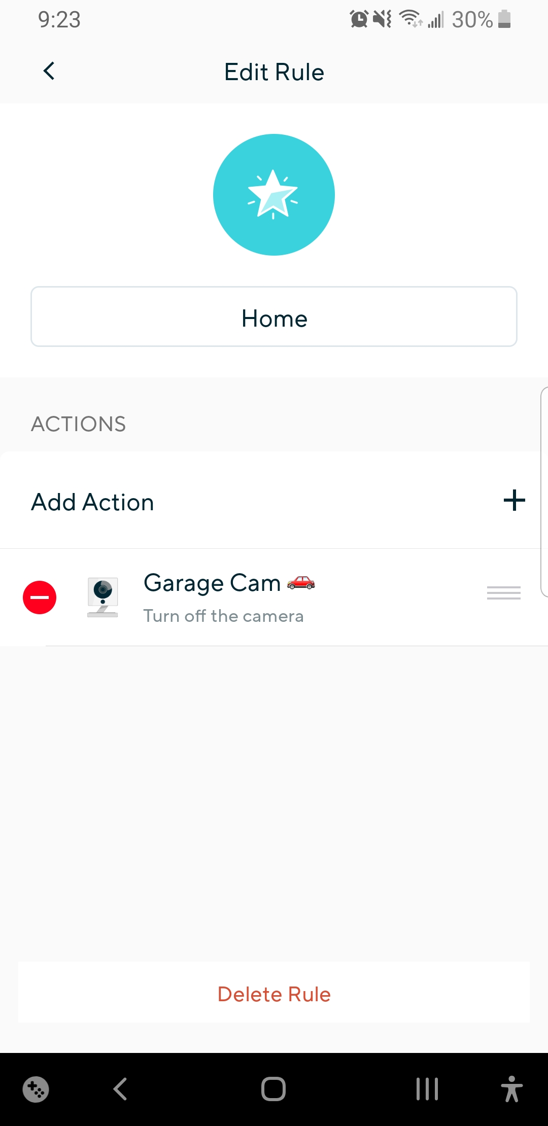

Create a rule that adds a shortcut (toggle) to turn off the camera when at home. The bridge connected to the camera still works along with all sensors connected to the bridge. I just double checked with my camera that has sense bridge to make sure. Walked into my garage, motion sensor saw motion, no event video created by garage Cam (which has my one and only bridge). Walked out the front door contact sensor opened, Alexa announced door was open, front yard motion sensor sees motion, front yard camera records clip.
As long as the camera with sense bridge is physically plugged in the bridge still works, when camera is turned “off” by the app it just gets put to sleep, still alive but asleep.

In a similar vein, do you care whether the camera is recording when you’re at home? For the purpose of my answer, I’m going to assume that you don’t want to have the motion sensors detecting motion AND you don’t need to have the camera(s) recording/running/online when you’re at home.
If that’s the case, then I think the solution is simple: Use a one-touch Rule “shortcut” to turn the camera(s) off when you’re at home and another Rule to turn it/them on when you leave. If the cameras are off, then the motion detectors won’t be sending any “record” commands to the offline cameras. Or rather they will, but the cameras won’t be recording anything because they won’t be online.
