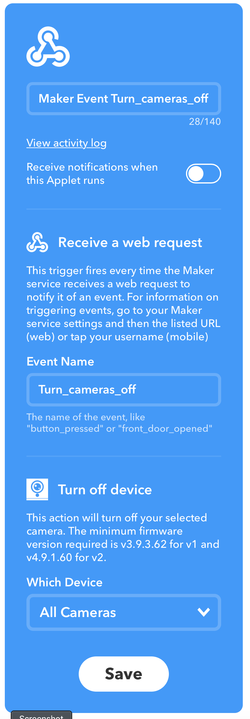

I am basically doing that but my notifications aren’t being turned off. It may be something I’m doing. I created two pairs of webhooks applets in IFTTT. The first pair turns the camera on or off, the second is supposed to turn the Wyze notifications on and off. The second pair seems to do nothing. When I edit (with gear icon) the first pair in IFTTT, I see the “Receive a web request” as well as the “Turn off device” blocks. When I edit the second pair, I only see the “Receive a web request” block. There’s no block for the Wyze. These two pairs looked pretty identical when I created them. I wonder whether somebody introduced a bug in the block between the times you and I created them. Here’s screen shot. How does it look on your end?
I don’t understand how to apply what you’re saying.
Are you saying that you don’t want any automation in your house to notify you when something happens and that you don’t want to be able to control any of your automation via the web (e.g., your smart phone)? You can’t really get notified or provide remote control without integrating the switches and technologies with the web. It makes sense not wanting any web-enabled automation. That’s not what this request is about.
Conversely, maybe you’re saying web automation is fine and just saying some things should be controlled as directly as possible. For example, door (switch) and motion sensors should talk directly to the cameras to trigger recordings. But that’s how Wyze sensors seem to work. Using general purpose switches connected to SmartThings for functions like that adds distance (technologies) between the switch and the device and requires a web service IFTTT). It makes sense to integrate switches through SmartThings. That’s not what this request is about.
Could you clarify?
Agreed, and I answered your question, I use IFTTT from smartthings to wyze to accomplish what you are trying to do as it would need to know you are home in order to automate it SO you Do NOT have to open your phone and run an applet… it happens automagically.
As for the rest… I was commenting on your statement that you didn’t know what smartthings would add, so I gave you examples.
Smartthings controls everything in my home. Garage door, door locks, lights, theater equipment, fans, leak sensors, thermostat, curtains, shades, shut off valves, outdoor lighting, cam system. Everything is based on rules, they may be based on presence, temp outside, temp inside, Lux reading(bightness), time of day, which mode my security is in or a combination of any/all of these, none of which require an interaction from me… That is by definition automation.
Automation should not make you do anything. If you have to pull out your phone, log into a website or tell HALexa to do it, you may as well walk to the switch, camera whatever it might be and operate it normally… Same goes with turning off cam notifications or any others when you are home… should just do it when it knows you are home.
As for my IFTTT recipe:
I recreated that today to show you. I deleted it awhile back as I have a dog and want to know what he is doing these days and what he is getting into.
So I’m using the same sort of widgets. Mine gets activated from Webapps, yours from SmartThings. Both appear to be built on the Wyze widget that’s supposed to tell Wyze to turn off push notifications. Mine activates when I’m gone and it appears that yours does too.
Unfortunately, the push notifications that get disabled aren’t the notifications that I need to have disabled. The push notifications seem to only control notifications from the camera part of the app. These are the notifications Wyze had before it added the sensor feature. I don’t need to disable those notifications because, as I’ve said previously, I don’t have my cameras setup to send notifications.
The push notifications I need to have Wyze disable are the notifications that come from the sensor events. In particular, the notifications sent when the Wyze door switch or the Wyze motion sensors trigger. The interface you’re talking about doesn’t seem to have any impact at all on that. I still get those notifications whether or not I disable the push notifications from IFTTT or disable the push notifications in the Wyze app.
Does that make sense? Have you found it to behave otherwise? Are you using Wyze sensors or are you guessing about that?
