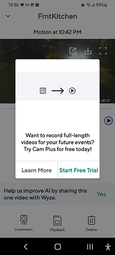

I am having a similar issue. I have 5 v2 cams. I have had name your price/CamPlusLite for years now on all 5. I got a new router a couple of weeks ago and for some reason I had to reset 2 of the cams. Unfortunately it took me to the CamPlus Trial. I couldn’t switch them to the CamPlusLite. The trial ended yesterday. Today one of the cams was on the CamPlusLite List but the other wasn’t so I was able to add it. Tonight I noticed that one of those cams isn’t taking video but has the picture icon in the bottom left corner of the screen, see attachment. Also when I go to play that video it won’t and opens up a screen trying to get me to sign up for the trial. I have also attached this cams notifications and it won’t let me choose “person” and says PLUS at the top. This is the cam I had to add to CamPlusLite. The 2nd cam that I had to do the trial with got added to CamPlusLite and seems to be working ok, but in the top of the notification screen it also says PLUS and I noticed it is do 21second video. But “person” was already enabled in the notification for this cam also.

Ok I have followed your instruction, restarted phone. My 1st cam that went to the trial is looking fine and doing 12s recordings. But it was automatically added back into the CPL after the trial was over. The 2nd cam was not. FrntKitchen. But it let me add a cam with the + sign. Despite following your steps cam 2 won’t take pictures now, but it does record the live view. I did your steps after noticing this and the same thing. Also the notification screen still won’t let me choose PERSON, but the PLUS is gone from the top. Question: (If this is not successful, you can also clear the OS cache after the Force Stop.) I have a Samsung S21+ and cant figure out how to do this. Getting older, thanks for your help and patience.

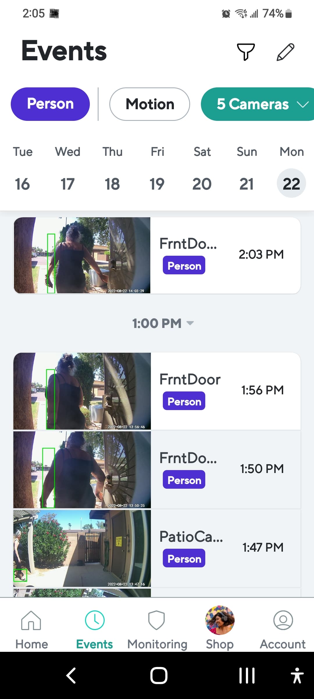

It is my understanding from previous Wyze posts that the user option to take still thumbnail snapshots vs 12s videos had been removed to mitigate confusion as to what plan level a user had. It is my understanding now that all cams (except the doorbells) on No Subscription get still image thumbnail snapshots (signified by the mountain\sun icon); all CPL cams get 12s video signified by the thumbnail snapshot in the Event list, no icon on the thumbnail, and no video length time listed (like all those in your screenshot above); CP cams get full length video events which will show the video length time up to 5m.
So, if Cam #1 and Cam#2 are both recording 12s video on CPL, it appears they are capturing video as they should.

Yes, these are Wyze V2 cams. All 5 have been on Name your Price/CPL for almost 2 yrs now about. I have attached screen shots of App version and firmware which is the same on all 5 cams. Yes, Cam #2 (frntkitchen) still has thumbnail snapshots vs video. With my CPL the only time I see 12s listed is when I go to view a video. Cam #2 (frntKitchen) is NOT recording video. Again let me clarify. I have never seen these snapshot icons ever until yesterday on the one camera that is giving me issues. I also on that cam cannot select Person Detection under notifications. Note on the attached screenshot that has Smart Detection at the top. It won’t’ let me select Person Detection because recording type isn’t set to video. How did that happen? How do I set it to video? As another poster stated. I cannot unassign my cameras either. Again, I never had these issues until I got new modem and had to add these 2 cams to CP trial. Again, trial ended 2 days ago. I did a chat and they couldn’t figure it out and had me send in a report id to Wyze. Hope I made sense, I am getting older and get more confused but think I am able to follow what is going on. I hope my camera isn’t rendered useless in using my CPL now
Cam #2 despite being assigned to CPL will still not record video.

When the Free CP trial expires, it reverted those cams to No License = Snapshot. Now, even though you have assigned it to CPL, it isn’t picking up the new assignment and giving you the 12s video. It still thinks you are on no license or on the old CPL which used to have the option for snapshot. We have to get it to believe it is on the new CPL without the snapshot option.
This is where you and I are both bewildered. That feature was removed. I have no idea where that setting was and I have no idea how it is giving you that particular text. If it isn’t in the Event Recording, I don’t know where to look. It shouldn’t even exist according to a post from Wyze. That’s why I am confused on this one. I haven’t seen those prompts since they discontinued the snapshot in CPL.
