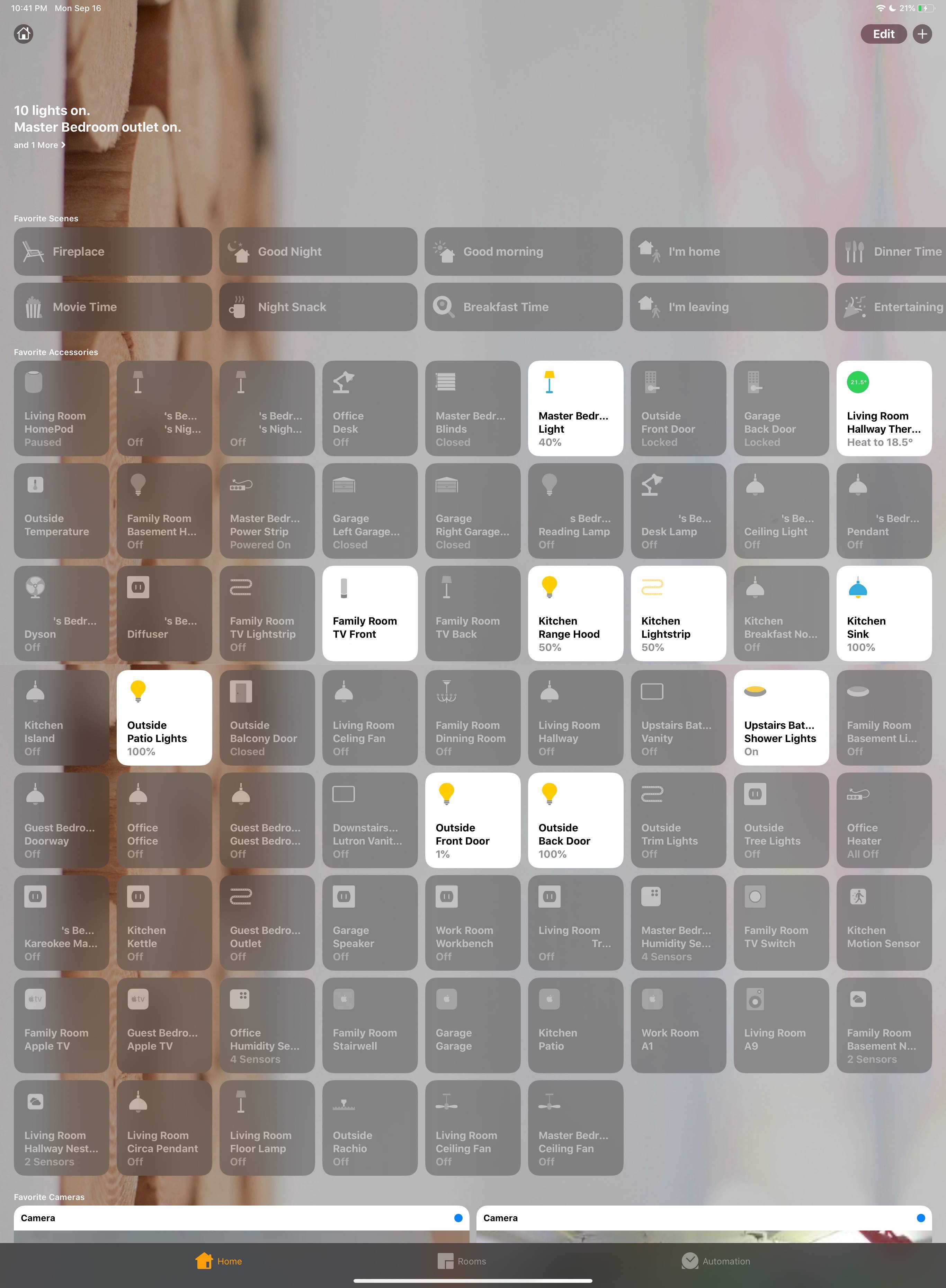

I am not so sure, I think HomeKit is doing very well but they have set the bar fairly high to join their ecosystem. That said it’s a pretty robust ecosystem already.
Edit* The above screenshot is not my system, I pulled it off the HomeKit subreddit. :upside_down_face:
