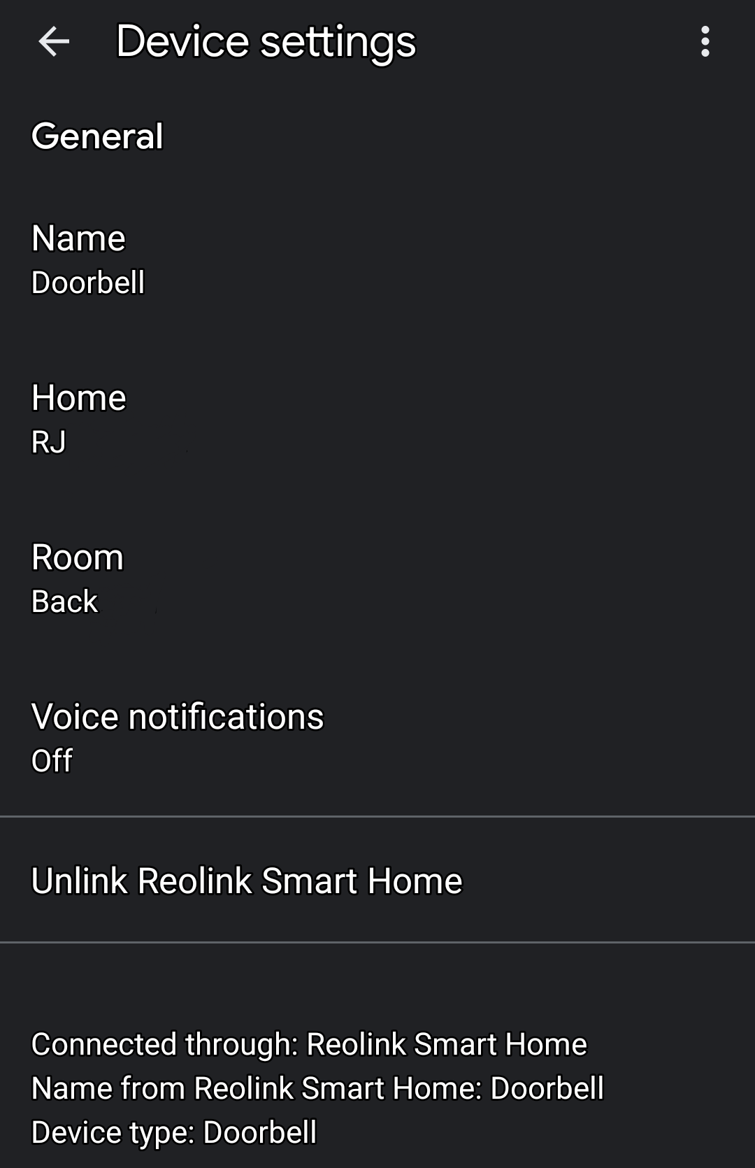

But even if that is the case, how are 3rd parties integrating Google Assistant notifications into their video doorbells when their button is pressed? For example, take Reolink Video Doorbell which supports Google Assistant Voice Notifications to cast an alert on Hubs and minis anytime the doorbell is pressed:
People have been reporting that works for Reolink already…how is Reolink doing this if it is all limited to Nest only and Wyze can’t do it? That doesn’t make sense. And if it isn’t limited to Next only, then maybe Wyze could implement the same thing so that we can get Google Assistant Voice notifications on Wyze stuff too.
I guess my main question is…if everything is limited to Nest Devices, then how is Reolink doing it? And if Reolink can do it, why can’t Wyze?

I believe the Reolink integration is for when there are detections, not for a button press. Correct me if I’m wrong and I will raise it to the internal team! We are looking into detections, but it seems like it could be deceptively long dev time due to how things are currently set up.
Unfortunately not, as we have to declare the type of device for the integration and are limited to what is available on the device type. Any kind of trickery, such as trying to declare two devices, will fail the review that Google does when we publish the integration.
I found some people saying it works for button presses now. Here’s an example:
https://www.reddit.com/r/googlehome/comments/153mtal/anybody_else_notice_3rd_party_doorbells_are_being/
Toggle on “Voice notifications” will cast an alert on all my Hubs and mini’s when the doorbell is pressed. I suspect eventually it will cast the video feed onto the Display in a future update.
