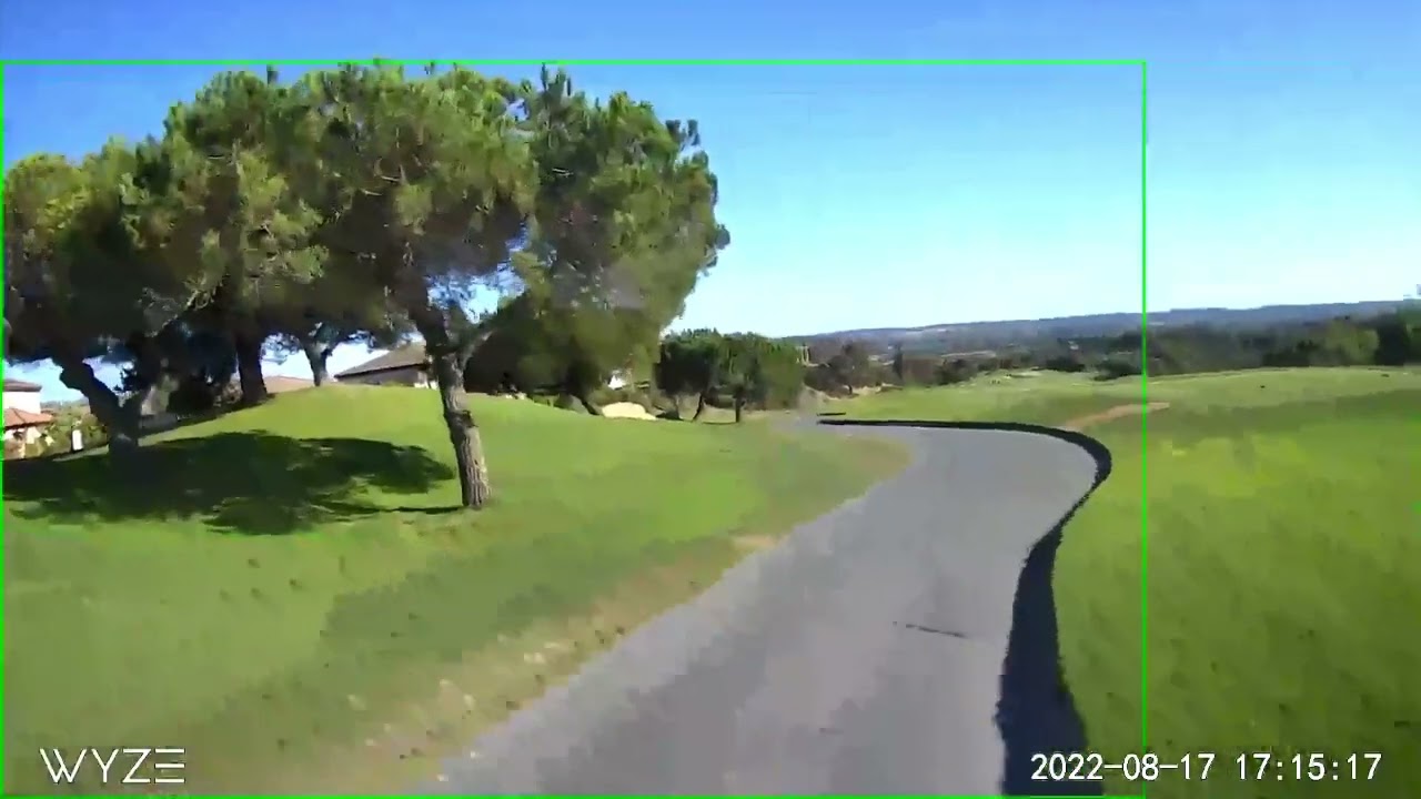

While I got some decent video while we were actually swing the golf club (I’d normally point the front of the cart at where we where golfing or turn the V3’s as needed in the mounts.)
What was disappointing was the video while the Golf Cart was in Motion (I wanted video of the course as well as recording us golfing)
I was hoping that the video recorded the the MicroSD Card might be better than what is recorded in the cloud. It appears that is not the case?
Wyze V3 as Dash Cam on Golf Cart 1 of 2
Wyze V3 as Dash Cam on Golf Cart 2 of 2
