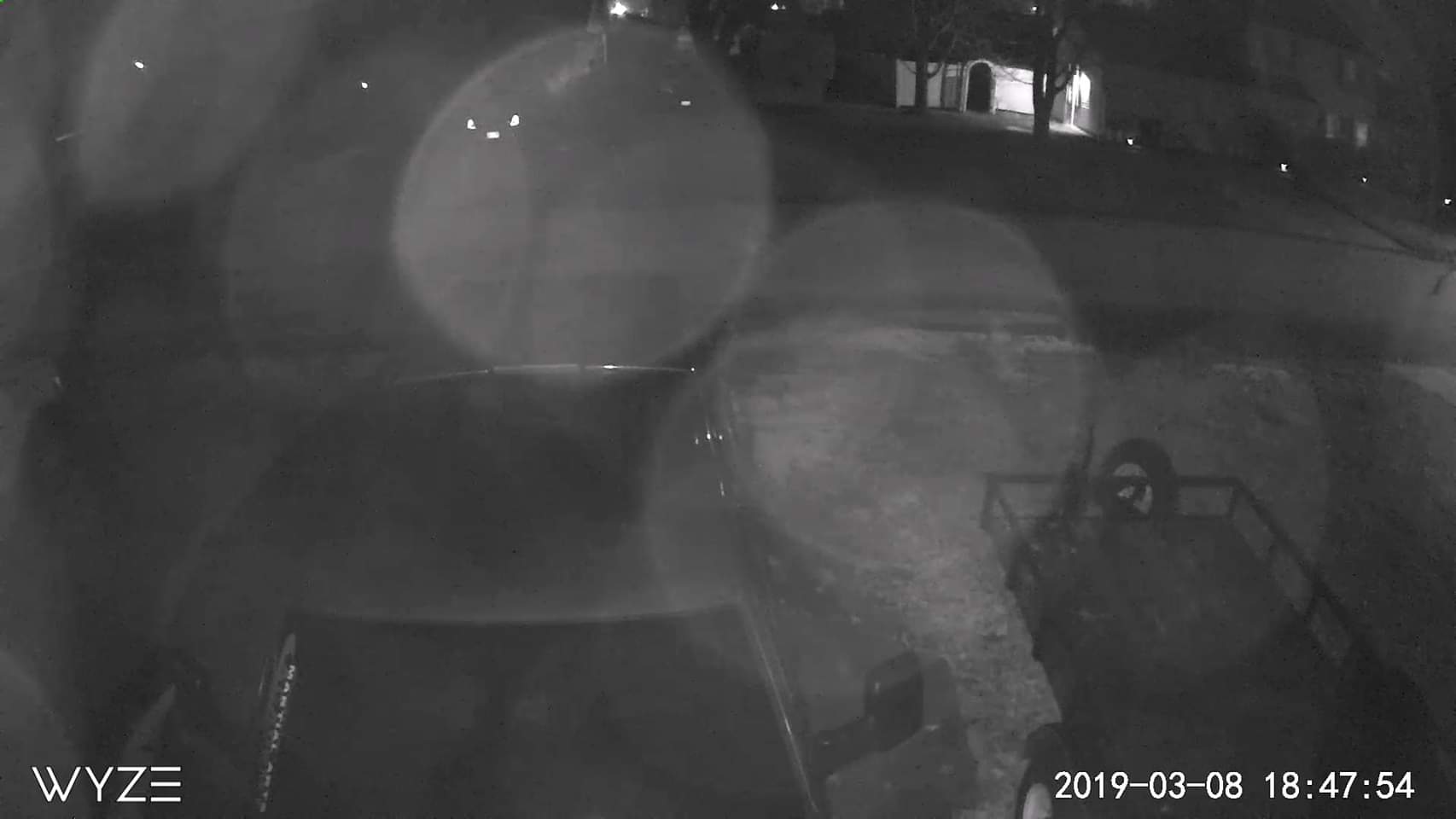

My V2 cameras have a weird glare on them at night vision. I have the amazon little bird house covers for outside (anyone use them?) I’m not sure if that is my problem or do they just have a glare from being out side. I’ve tried committing on wyze fb page but can never get an answer so thought I’d try here

If you are able to, disconnect your camera from the mount and try in a more controlled environment. I use a portable battery pack (used for charging phones/tablets) and my garage to test IR.
The glare may be coming from the white edges of the cover. I bought the black version because of that issue.
That is what I’m thinking also. I was thinking of taking them down and painting them black
This is what I’m getting on all 3 I have
Other members have painted theirs black as well. :slight_smile:
As Dread mentioned, try painting it black.
Amazing what alittle black paint will do!!! Thanks for the help guys going do the other 2 tomorrow

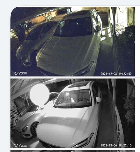

FYI, I just had this issue. It went away after I cleaned the lens with some sunglass hut lens cleaner and a micro fiber towel. I’m pretty sure these are water spots on the lens after having been rained on…

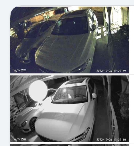

There must be something going on beyond watermarks. Here is what I am getting with my carport camera daytime vs nighttime. Can’t get rid of the white spot and it keeps triggering events every few minutes overnight.
