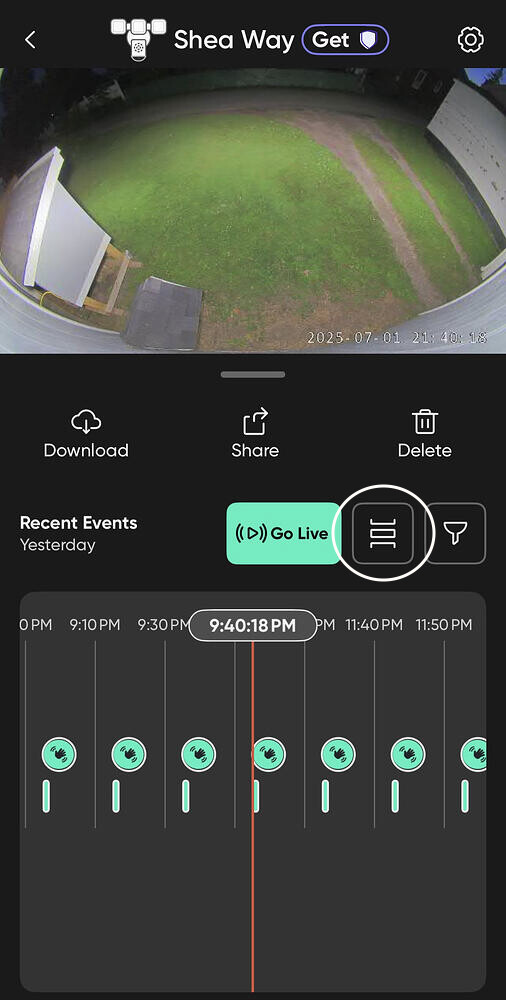

I have always accessed the recorded SD card footage of my cameras by selecting that camera and viewing the photo snapshots in the “Events” tab. When I come across the time period I want to view I select that snapshot and then click on the “SD Card” option at the bottom.
My issue is not with my v3 or v4 cameras I have. I can still do the same I mentioned above but my issue is with the two Floodlight Pros I own. I accessed my SC cards the ame way described above on the Floodlights Pros for as long as I’ve owned them. There must have been some sort of Wyze change recently that prevents access to my SD Card.
Now when I select one of my Floodlight Pro cams and click on SD Card I see the usual cam footage on top but the bottom scrolling option has changed. It’s all segmented into “motion” events and when I scroll the red line in between these events (to view the footage that I have recorded as ‘continuous’) then I’m bumped to the nearest event instead. Even then, it doesn’t actually show me the footage of it. The still screen shot above in the window remains the same. Notice the time selection I made with the red line is not what is shown in the video footage above (see pic for my issue). Both Floodlight Pros are like this. This issue must be on Wyze’s end.

Try clicking the circled icon.
All that seems to do it toggle between two different ways of viewing the same info but neither allow me a
to access my continuously recorded footage.
With this screen, you’re looking at the timeline of the SD card content for the day. I don’t know of any other “SD card content”. Are you expecting to see individual 1-minute files?
The newest app version (676) has modified this screen; now you get a calendar to let one pick the day of the “SD card content”.

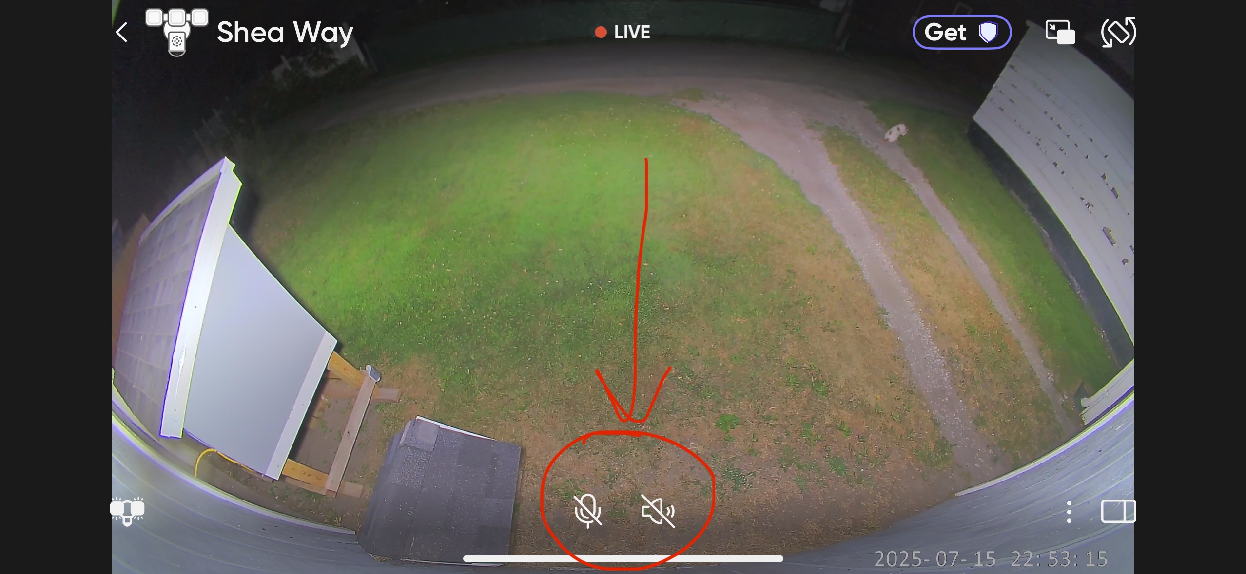

I’ve had this same exact issue - all my wyze cams (V4 and V3 are working fine but the SD card option is specifically missing from my two (2) Wyze Floodlight Pro’s.
I also just noticed that I can’t toggle on/off the microphone or speaker to the camera.
I tap the picture so the options appear however when I touch either icon it remains s crossed out.
