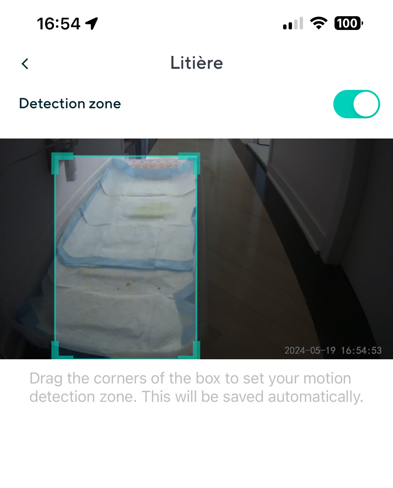

Hi!
I have Wyze V2 Cameras and I’ve lost the detection grid and am stuck with only stretch to fit square.
Steps I’ve Taken:
- Restarted the cameras.
- Unplugged/replugged cameras.
- I signed out and back into the app (I also turned on 2FA because I’m a cooperative guy
). - Cleared the cache.
- Deleted the devices/cameras and added them back.
Nothing worked to bring back the grid. I saw where this was an issue in the recent past, but it appears that I’ve caught the bug.
This condition is creating lots of false triggers. I’d love if someone could help me “Fix-It!”
Software/Firmware Versions:
- iOS App: 2.50.6.1
- Wyze Cam V2 Firmware: 4.9.9.3006
Thanks!
EDIT: Amending this to include that I removed and added all of my devices because I switched to a new modem/router/gateway since I last used my cameras and bulbs should that somehow factor in? Thanks!

Every single [v2] camera has this issue.
I submitted this exact information in my post in a ticket to Support to see whether I could find anything out directly, and they responded the next day with what has to have been a stock reply because it suggested everything I’d already tried, adding only to try restarting the phone (which didn’t help).
I’m pretty disappointed because It’s clear that they hadn’t read what I’d written, or if they had, couldn’t be bothered to customize the response.
EDIT: Specifying that I’m using v2 cameras.
