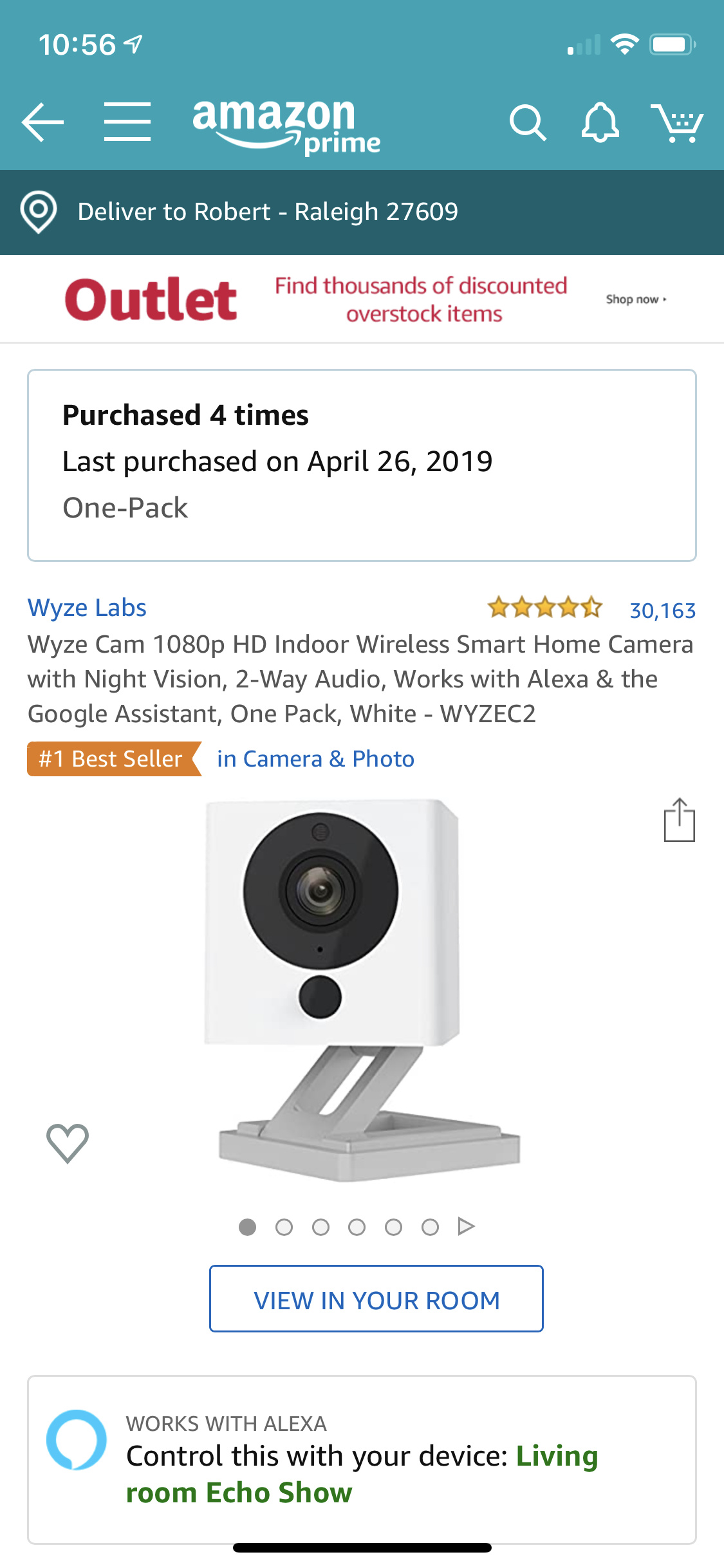

A legitimate camera says Wyze Labs not Wyze and Sold by and fulfilled by Amazon. See below:
