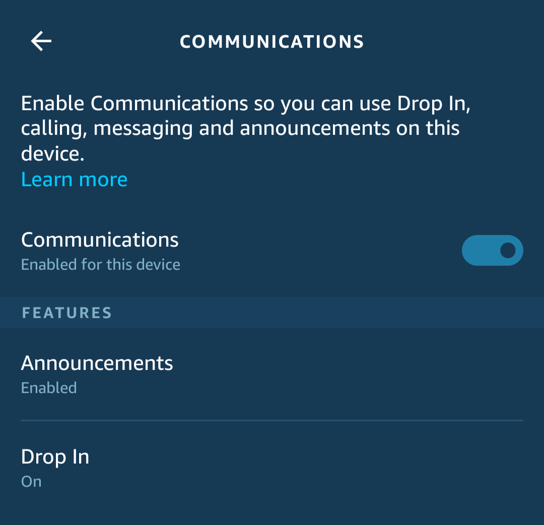

Back to your HD10. If you go into the Alexa app, then to the HD10 device under devices… there should be a Communications settings. If Enabled looks like there are more options, one being Announcements.
If you haven’t already done so, I wonder if a configuration tweak in there changes anything?
Like if communications is disabled and you turn it on, you can then disable Announcements?
I think you’re a genius - this will probably fix it! Thank you!
Of course it will probably prevent other Alexa announcements but that’s okay as it’s right next to a real Echo anyway.
