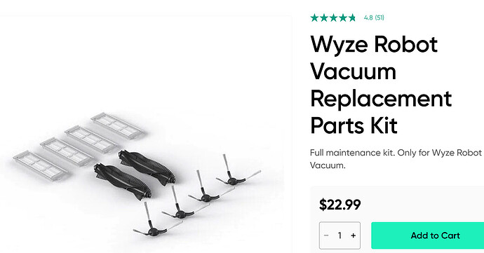

you can order the replacement parts from the Wyze Store for 22.99:
