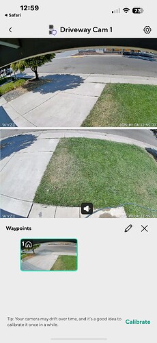

Mine is drifting down over and over. Calibration works for a few hours.
Thanks for the feedback— sorry to hear it’s still drifting.
Would you mind sharing a bit more detail about how the offset appears? If possible, a photo or short video showing the drift would be super helpful.
Also, could you please submit a log through the app? That’ll help our team dig into the issue more effectively.
Thanks so much for your help!

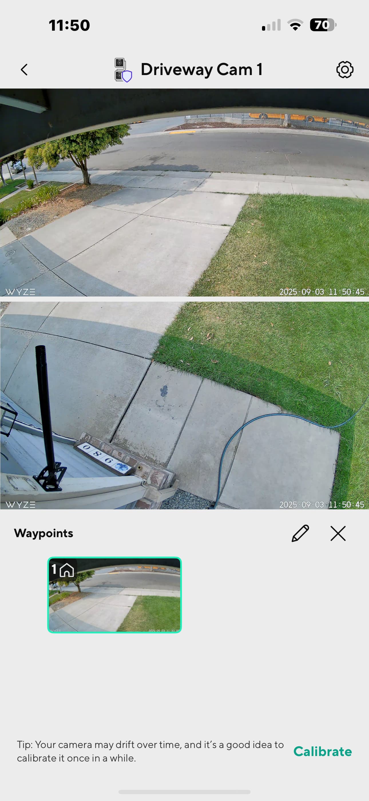

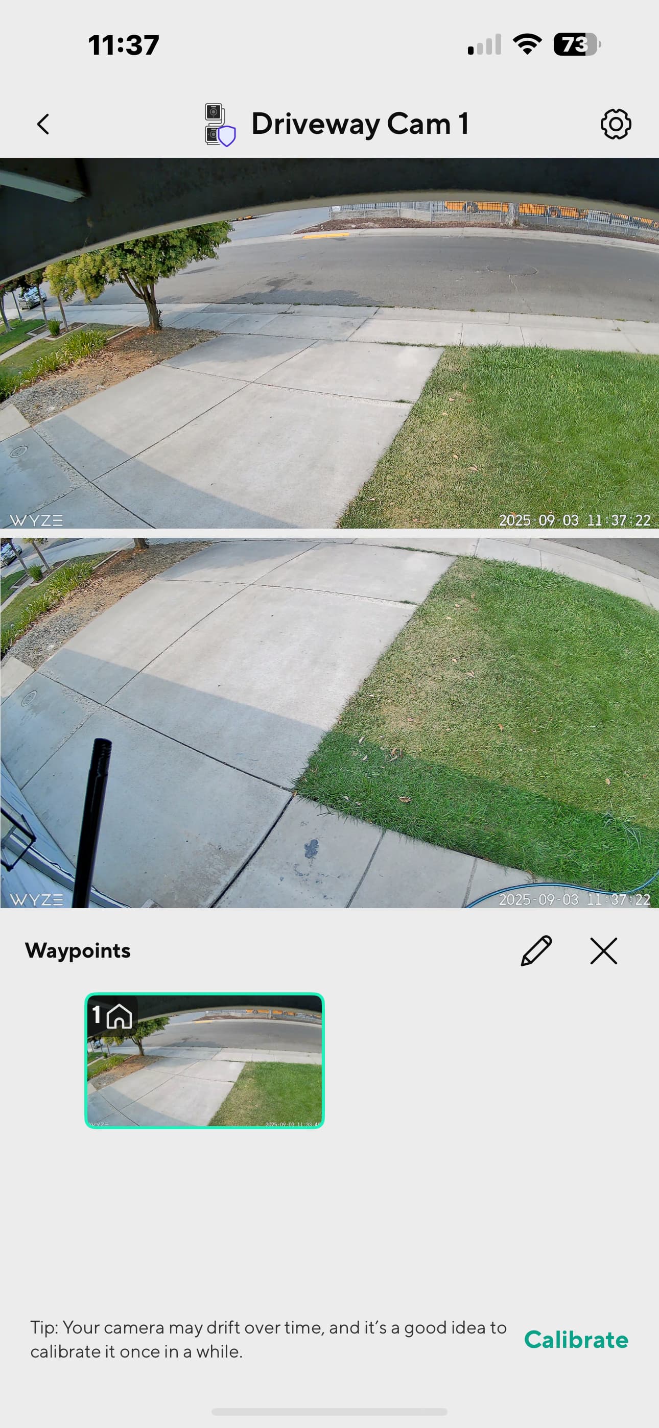

Heres a couple screen shots
From the image, it does look like there is some drifting happening.
Would you mind helping us by trying the following steps?
  1. First, please turn off Pan Scan and Track Motion.
  2. Delete any existing waypoints.
  3. Manually calibrate the camera — once it returns to the correct forward-facing position, set that point as a new waypoint.
  4. Reboot the camera.
  5. Then, enable only the Track Motion feature (leave Pan Scan off).
After doing this, please observe whether the drifting still occurs.
If it does, we’d really appreciate it if you could submit a log through the app and share a photo or screenshot showing the issue.

At 11:05 is when it finished re-booting with new set point with tracking on and panning off then other screenshots in a span of 30min
Log #: 1989349
Thank you so much for your feedback!
To help us investigate further, could you kindly confirm a few things:
  1. It looks like the log submission didn’t go through — would you mind trying to submit it again through the app?
  2. Could you take another photo showing how the camera is installed (ideally a wide view of the setup)?
  3. Has the camera experienced any strong physical impact during use (e.g. hit, dropped, bumped, etc.)?
We really appreciate your help — it’ll allow our team to better understand what’s going on.
Thanks again!
