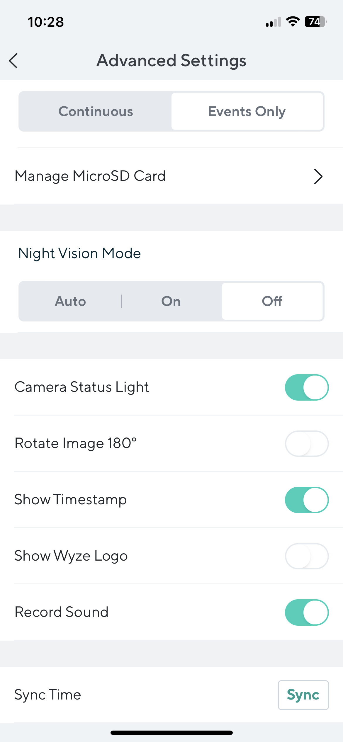

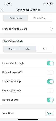

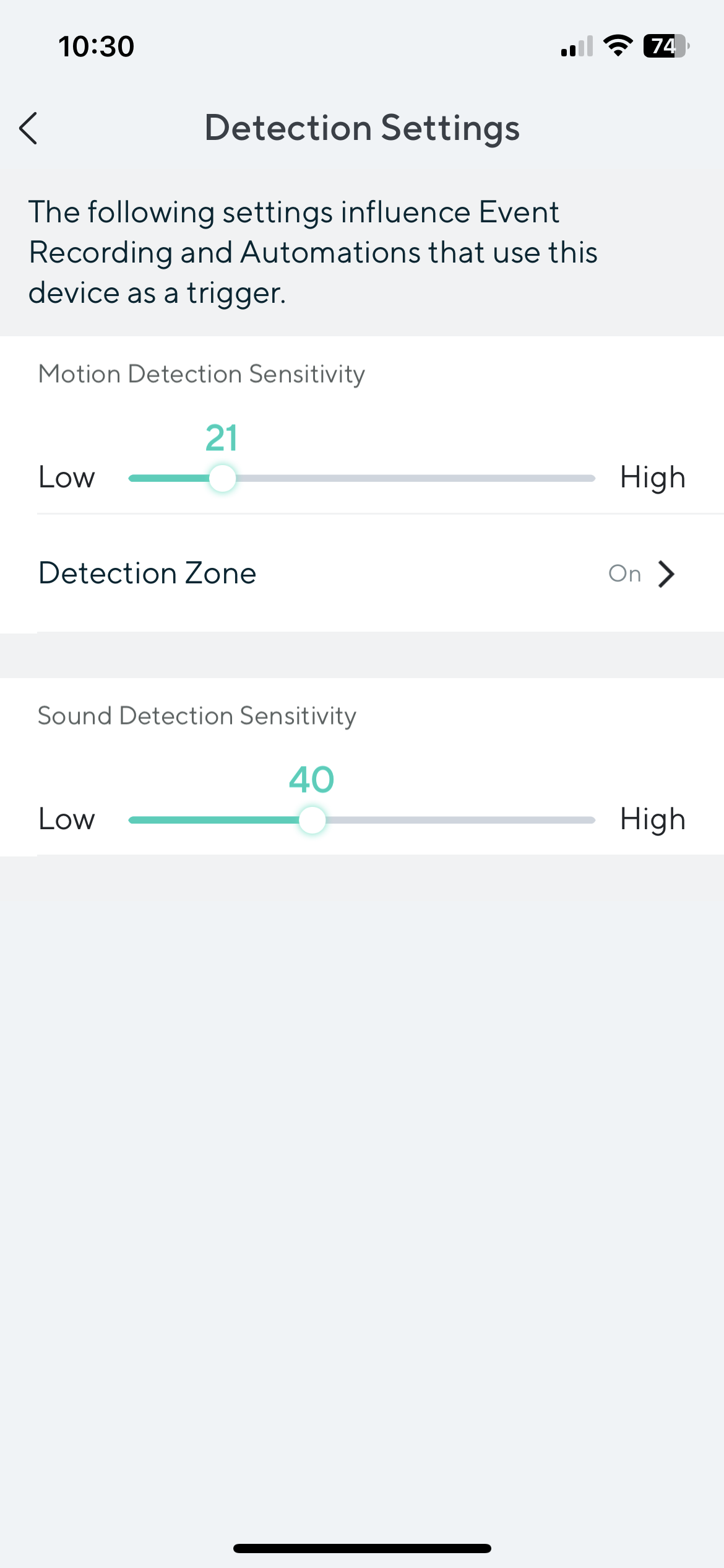

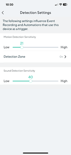

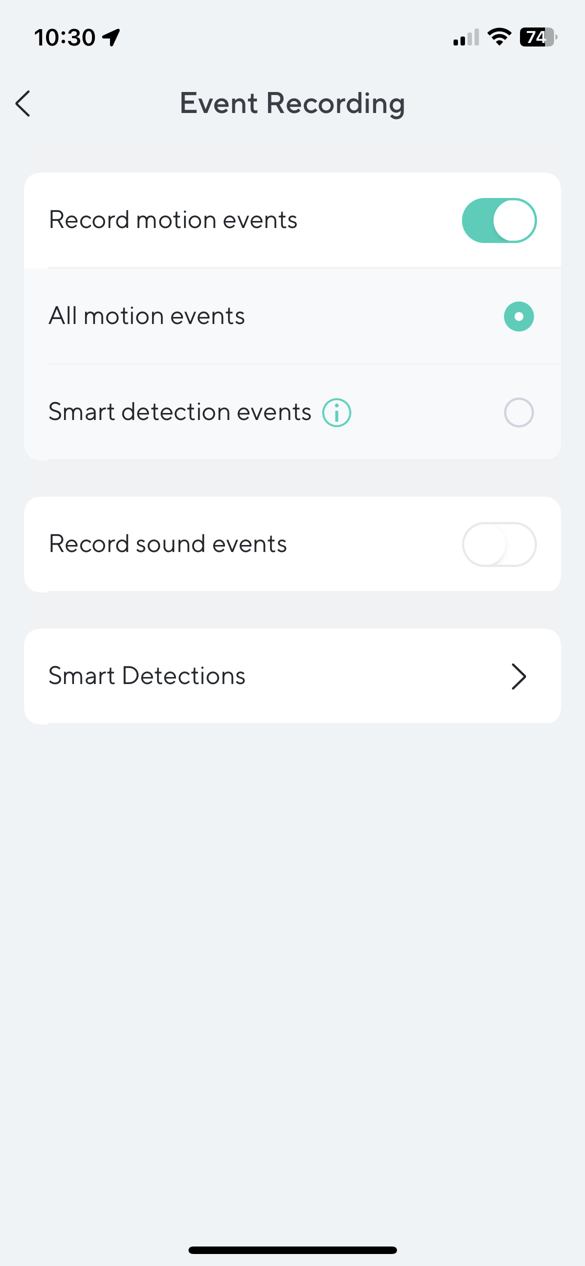

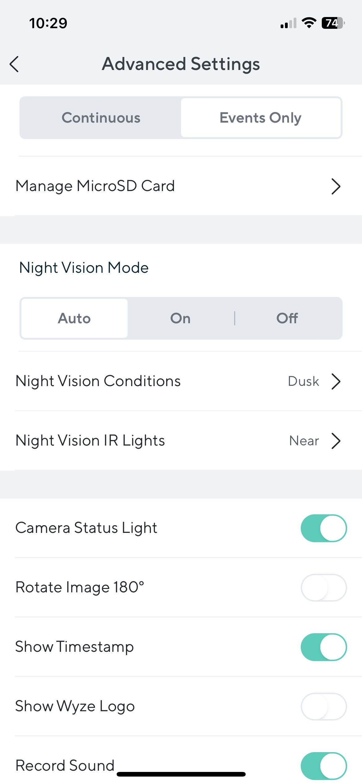

Attached are images of my settings.
Rick Allen
Theme Park Design Director
From the settings you have posted, Motion Detection Sensitivity at 21% seems quite low.
You also have a Detection Zone restricting motion detection in a portion of the FOV. That can also be a deterrent to motion event activation.
The filters you have set in the Events tab may be restricting you from viewing all types of events. Those need to be reviewed to make sure the cam or motion\AI type isn’t being excluded from view. If you Clear All, it should show all videos on the server for all cams. Also review your notification settings to make sure you are set to be notified for the event types that you want on each cam.

I lowered the Sensitivity to 21% in hopes that the camera would only detect people of cars entering my lane way.
I set the Detection Area not to include the road.

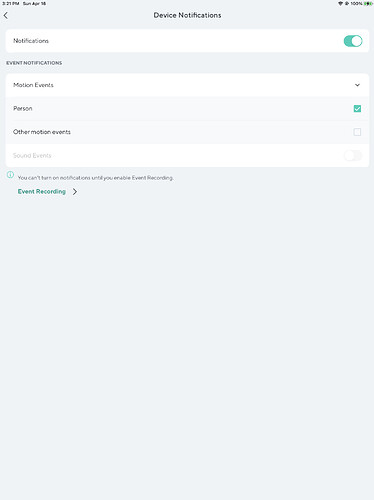

Rick, try setting your Detection Sensitivity higher than 21. I run mine at 90. The one screenshot you did not post above was each cameras Notification screen. Here is mine. I have only Persons checked so I only get notified when someone walks in front of my house. All motion is recorded, but I filter my Event viewing to only look at only videos with people (unless I do want to view all motion Events). BTW, I have CPL, so your Cam Plus Notification screen should have more toggles. If this gets you closer to your liking, then add Detection Area rules and other stuff. Good luck.

  1. Enable Event Recording for All Motion Events and any Smart Detection AI Events you want.

  6. Set your SD Card recording to Continuous. If you still have problems getting SD Playback footage, pull the card, reinsert it and reformat it in the Advanced settings Manage SD Card menu.
