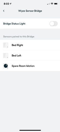

I have two contact sensors and one motion sensor attached to a Sense Bridge in a V2 camera. The contact sensors keep ending up offline in the app. The motion sensor remains online and it’s status stays up to date.
The motion sensor is about 5 feet farther from the bridge than the contact sensors. I have tried the bridge in 3 different cams 1 of which was only 3 foot from the sensors.
The contact sensors go offline multiple times a day. Restarting the camera the bridge is connected to restores their connection for several hours.
The motion sensor never goes offline.
The batteries show fully charged in the app and a multimeter confirms they are fully charged.
Any ideas? Could the bridge be defective?
