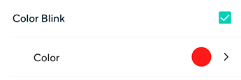

2 months ago, I created another rule (the “flash” rule), that on motion detected by a V3 camera late at night after the first rule has turned the bulbs off, it flashes these bulbs in different colors of blue and green, to alert me of the late night motion. This flash rule has been working with no issues, and the sunset rule continues to turn the lights on yellow, even though the “flash” rule colors are green and blue and the sunset rule does not specify a specific color.

I’d say that is expected behavior. The “color blink” action is a temporary action that is sent to the bulbs. It blinks a color a few times then reverts to it’s precious state, to which in your use case is yellow.
On your last rule with the white color. Your action is to change the color white, which is a one time rule that changes the color of the bulb. I’d expect the same behavior with brightness action. It sets it to your chosen setting. As a fix for your rule I would add a “change color to ‘yellow’” action to your first rule, or which ever rule you want the yellow to be.
The “color blink” action is a temporary action … then reverts to its previous state
