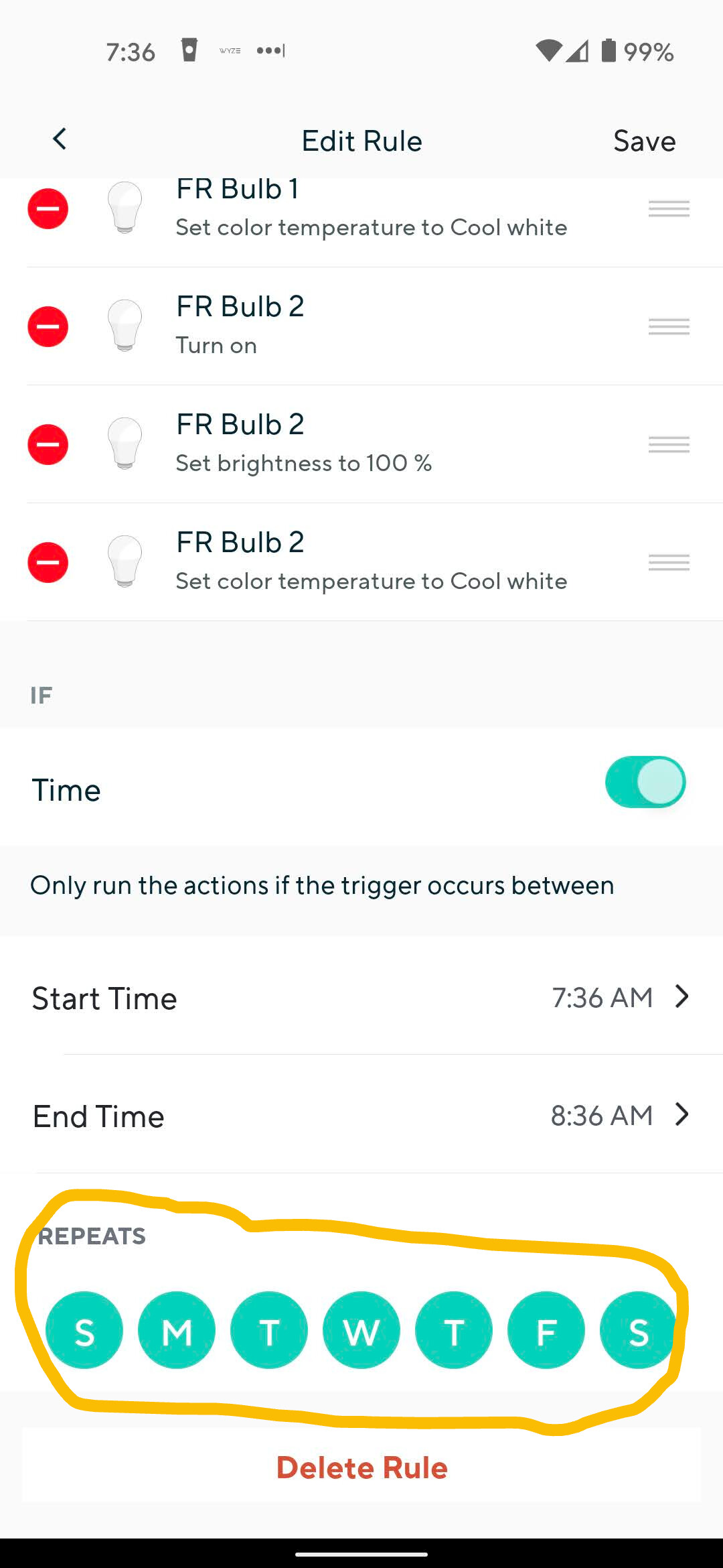

When you set your rules and select days of the weeks and time, are your days of the weeks represented as the first character of the day in a circle colored green when selected? Or so you have to check a box to select the day of the week.
Asking because I am on the new Rules engine but not sure if it has been fully released yet. I’d you have the first character in a circle, then you are on the new Rules engine.
Here is an image of what I was mentioning on the days of the week.
