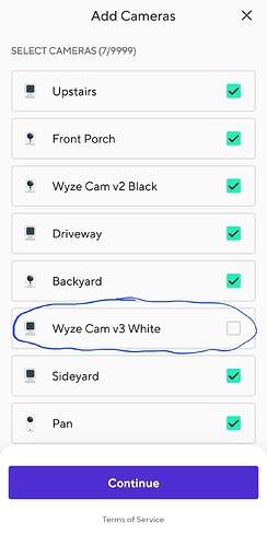

Can't add new Wyze Cam v3 to Cam Plus Lite
Why can’t I add my new Wyze Cam v3 to Cam Plus Lite? I check the box, hit continue and it won’t work.

CamPlus Unlimited/Lite is broken and has been for a while.
Did you ever figure out the problem of why you couldn’t assign a camera in cam plus lite as I am having the same issue.
No, it still doesn’t work and I haven’t heard back from Wyze support.
