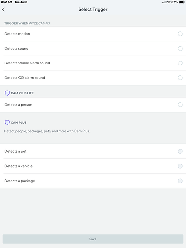

Scenario…A camera is set over the garage door.
…IF camera sees car…THEN sends signal to plug. Plug turns on (floodlights) and shuts off after preset time interval. Bonus points if i can do this between interval periods (at night)

Looks like I’m wrong. With CamPlus there’s an option for vehicle detection which MIGHT make this an easy automation.

What you’re describing should be possible with Wyze Automations, including having your Trigger function within a defined schedule (e.g., at night). The questions that come to mind for me are these:

What I’m imagining now is that you’ll be running Cat 6 for the Hikvision system (I’d guess for PoE), and that this is going to be your self-hosted system for on-site surveillance and then you might have a handful of Wyze Cams sprinkled around that you’ll possibly want to trigger dumb floodlights. That seems like it should work, especially if this is a new build and you’re comfortable rewiring the lights anyway. Doing something like that, I’d imagine you could run your own electrical cables for the floodlights and have them all terminate at a bank of indoor Wyze Plugs that you’re using essentially as switches, and then you could use Automations to trigger those based on camera detections. If you’re comfortable basing all the triggering on generic motion detections (in contrast with Person, Vehicle, etc.), then you could do all of that even without a subscription, and I think the effect would be similar to what you might achieve just using the floodlights’ motion sensors.

I haven’t done this exact thing, because I don’t have any floodlights at my home, but I have used Plugs in camera-triggered Automations, so what you originally asked about is possible within the Wyze ecosystem, as @WildBill indicated. Whether or not it’s the ideal solution for you is another question entirely. :wink:
