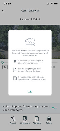

I just started receiving errors today for a V2 running with CamPlus. In the event tab there are videos listed with PERSON, VEHICLE and MOTION tags. When I attempt to view them I get an error message saying that the video wasn’t uploaded. Seems to be happening with all the CamPlus videos for at least the one camera. Haven’t tested others yet.

And this issue only happen on my V2, it’s working perfectly fine on my V3. The notification shows videos were captured but unable to play with the error message.
Initially I did a powercycle and now i added a smart plug to powercycle my V2 devices everyday. It solved the issue for a moment, maybe less than an hour that i am able to play the CamPlus recorded video, but after that the issue comes back.
I also did remove V2 from CamPlus, and then reassign the V2 cam back to CamPlus, it worked for less than 30mins and issue came back.
I also did a factory reset, and readd my V2 device back to the app. Same result, it worked for a moment, and the issue returns after about an hour.
